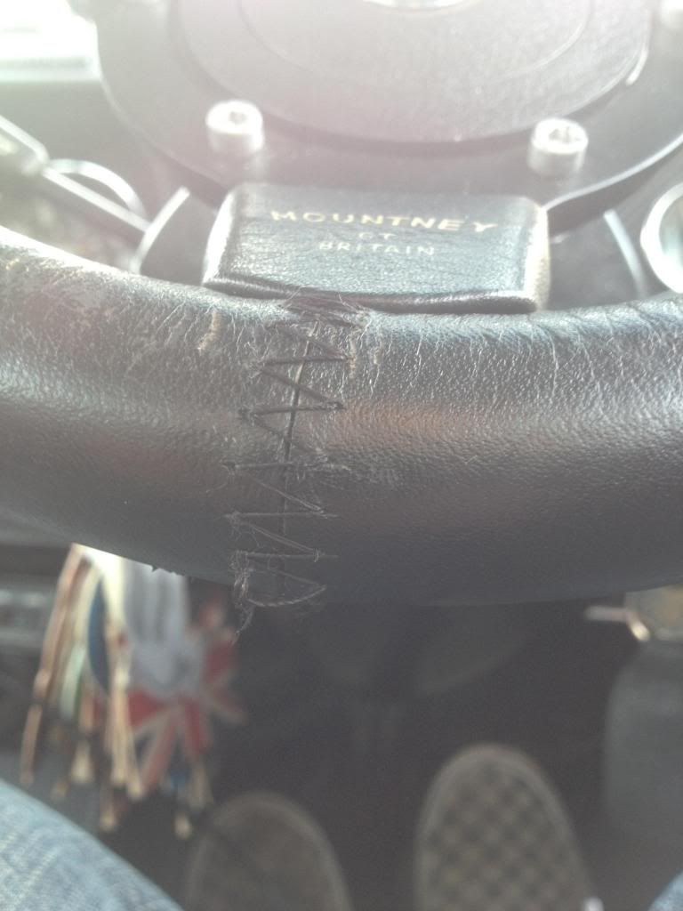

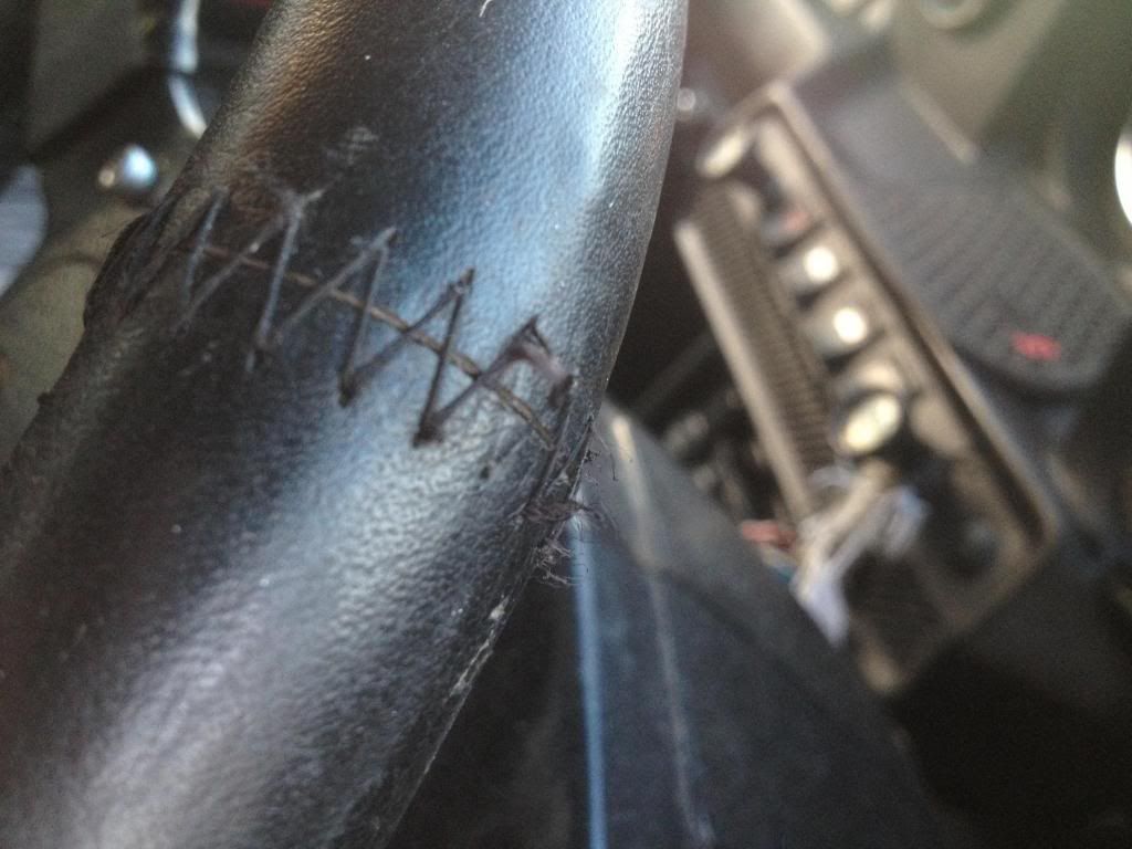

The join stitching at the bottom of my wheel has broken and is just beginning to come undone.
Anyone have any suggestions on what i might do to repair it?

You could have a go at re-stitching it.
For ease if you have a curved needle as well as a straight needle to hand, and some strong upholstery thread you should be fine. This is the kind of thread I mean:
http://www.ebay.co.u...g-/280782670061
I'm no expert but managed to restitch an entire leather wheel in about four hours following the original path of the thread. I'm a bit of a perfectionist but even I think it looks as good as new. Have a go!

Sorry, for some reason I missed your reply.
I've temporarily superglued the loose thread into place, it's lasted well and looks fine.
I wasn't sure I'd be able to do it, but when this glue finally gives, maybe I'll give it a go, thanks :-)
