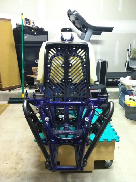

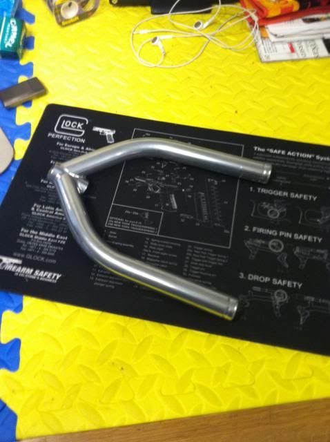

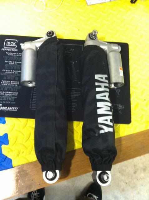

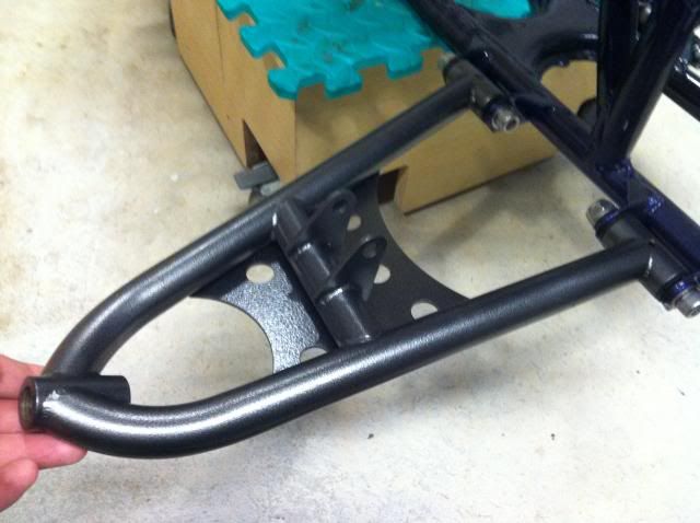

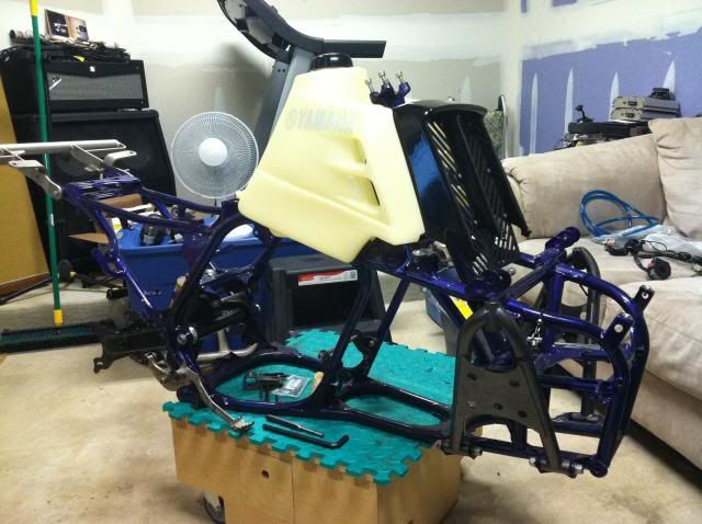

As promised....garage is a little cleaner, so I took some pics. I was listening to "The Darkness" this morning and decided I'd reinstall the swingarm and rear shock (as well as grease it all up!). Here is the pics:
(The little cart Roofless left at my old pad in Flempton serves as a VERY nice stand for my Banshee!)

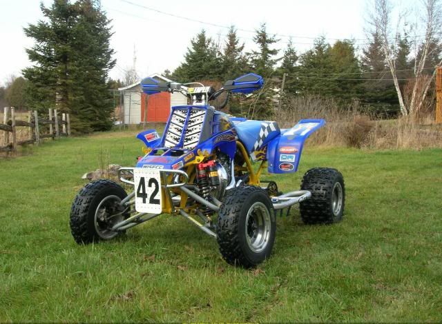

This is more or less what I'm aiming to achieve (only different color scheme of course....)

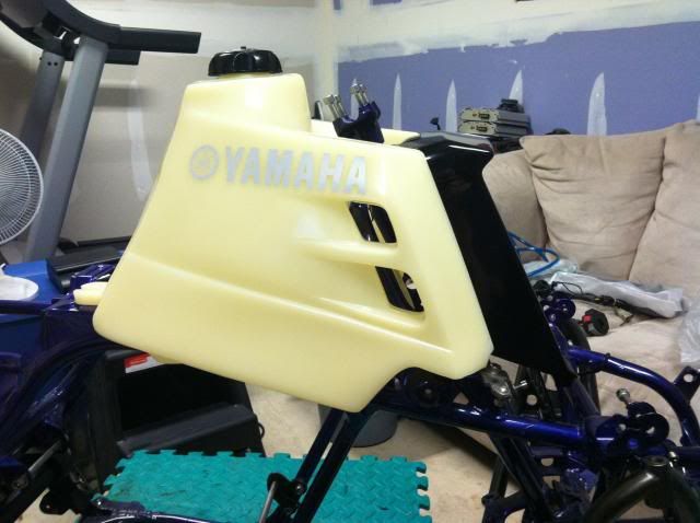

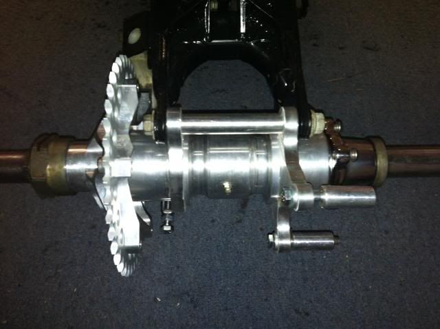

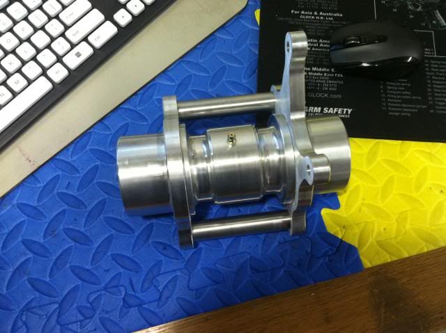

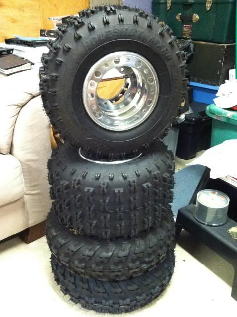

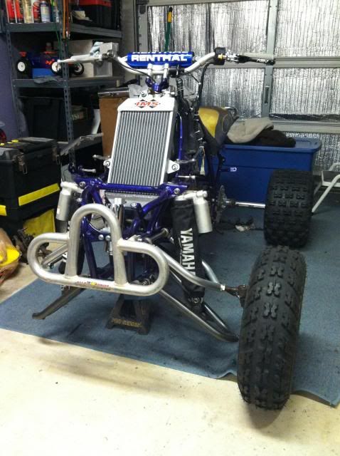

Well, I've now got the engine in as well as the front suspension (and rear!) installed. I gotta get some fresh boots for the ball joints then I can carry on with the front brakes and put the front wheels on.
I ordered a billet alloy rear sprocket hub, my stock cast hub was apparently bent! Once I get that hub I can put the fresh 41 tooth Renthal chainwheel on and commence finishing up the rear axle install....bottom line is I'll have this monster on fresh rubber soon enough.
After I get it rolling I'll be able to focus a little on the engine. It's pretty dirty and needs degreased and pressure washed. I'm a stickler for things being CLEAN.
I had to go back to the OEM gas tank for the time being, the 5.5 gallon Clarke tank needs fiddled with to get a good fit. What a pain. So, now that I'm going to use the stock tank for awhile it'll need a fresh petcock and fuel filter...as well as an OEM tank shroud. On a side note I found a local Honda/Yamaha dealer that charges around $40 to use their dyno! That's SICK! My initial guess is as it was when I bought it it was pushing close to 60 horse to the rear wheels. I'll be changing the FMF pipes to a new set of Toomey T6's as well as advancing the timing and adding a cool head and some bigger jets for the carbs. It should have no issues pushing around 70ish horse to the rear wheels. Stock they are around 35.
I'll post some more pics once I get some more progress made....right now it's just a project surrounded by tools, parts and more parts! :)

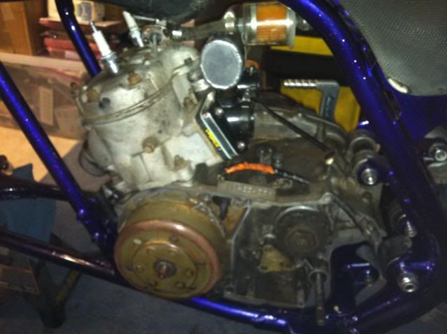

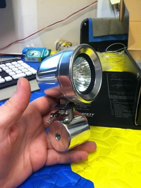

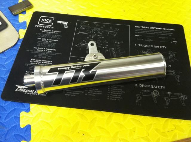

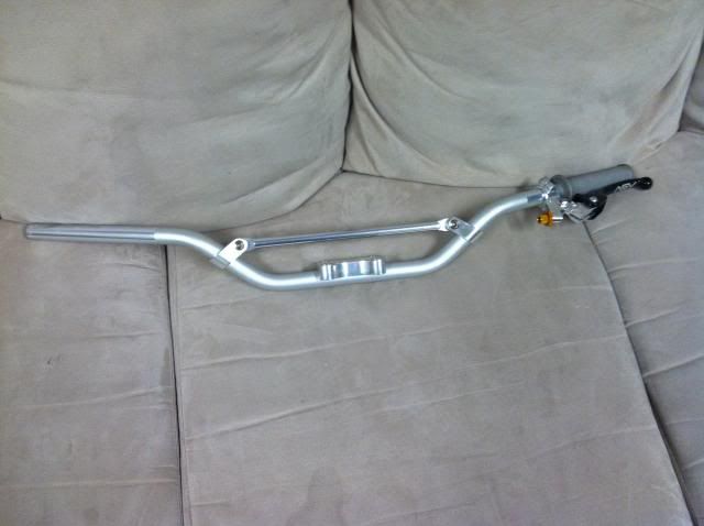

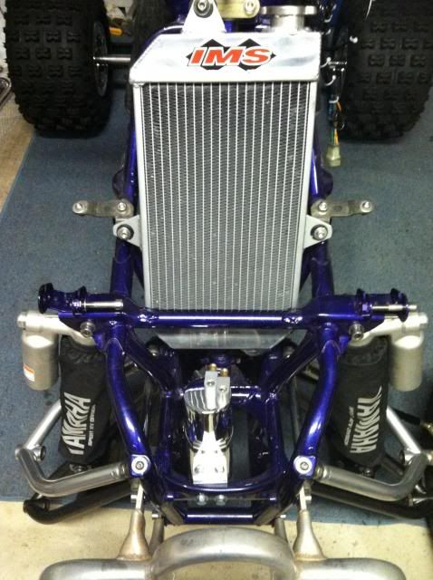

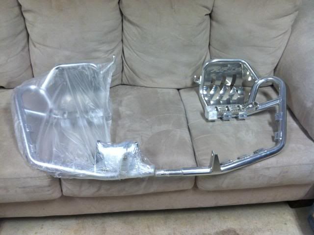

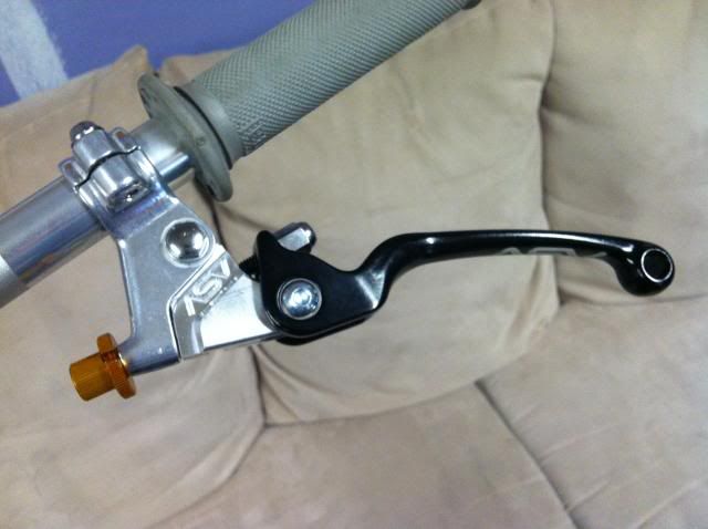

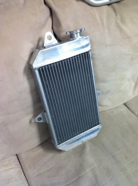

Ok! Not sure if anyone is still following this thread...but here's some more pics of the build. Many things in these photos will change as I'm still test fitting parts and just generally making sure things are going to bolt up properly before final assembly.

Well, I pulled the clutch cover this morning. Turns out the idler gear has a worn out bushing, I found the circlip and the claw washer sitting in some sludge at the bottom of the clutch cover. Thankfully it appears nothing was damaged. Time to order an aftermarket steel bushing (the OEM version is bronze) and a fresh circlip. Hopefully when I pull the clutch I'll find nothing else messed up.
