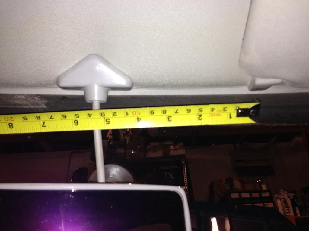

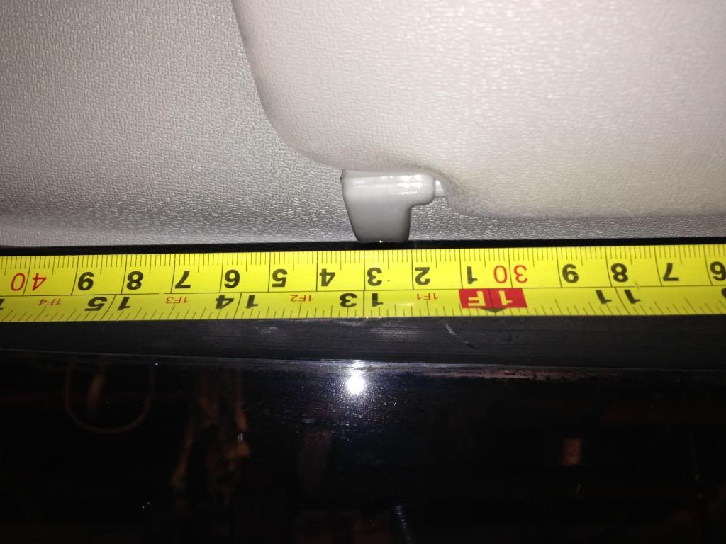

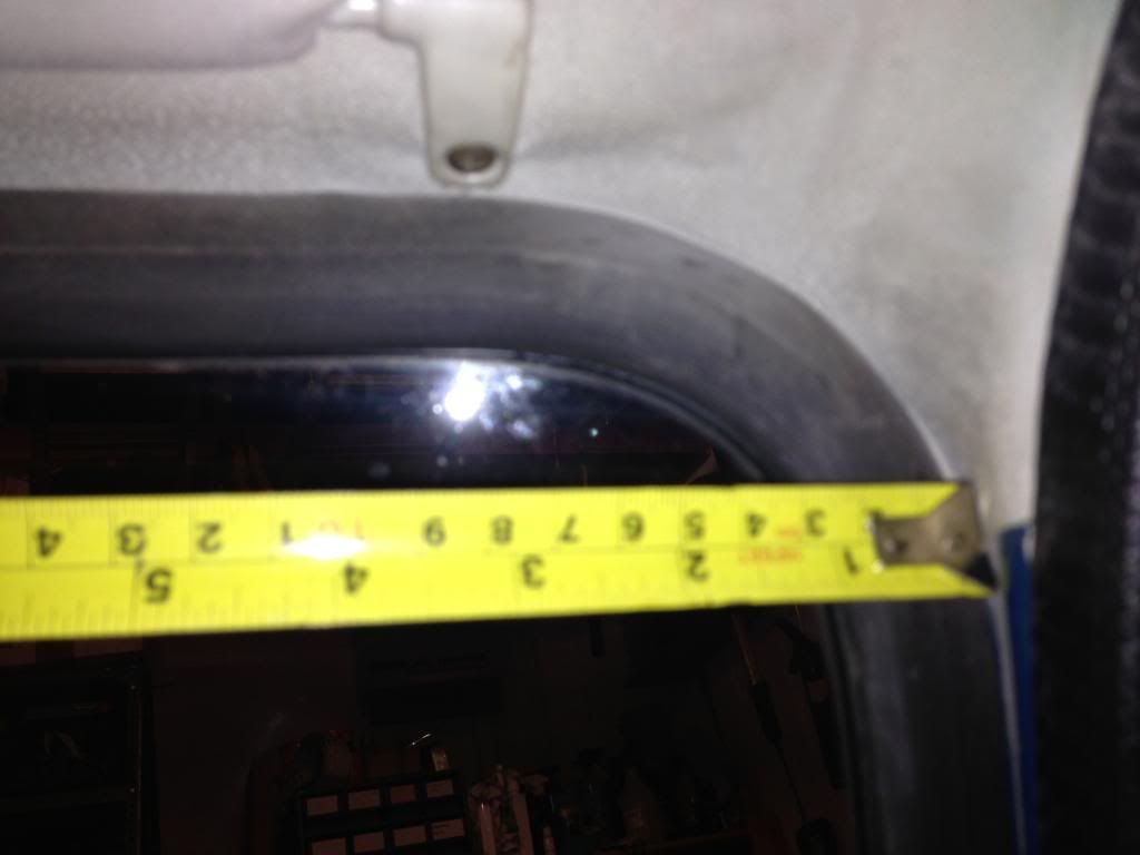

Last go so use my earlier measurements i have already posted
Not the best picture but you can see where i started the measurements
This picture shows you the width / pitch between the visor mount screws
This is the measurement between the inboard visor screw and the centre of the mirror.
