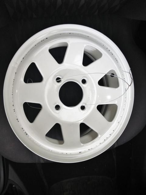

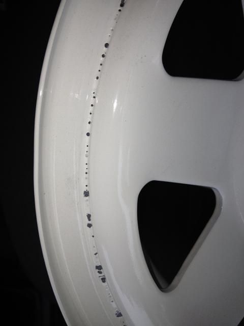

took one of my wheels for sand blasting and powder coating test but mixed results
The groove rounde the outside of the wheel 'stored' some of the powder and when baked it popped and left the results shown.  Fella said he would just blast it off if not happy so no problem.
However,  if I can weld the gap shown I can have them powder coated nicely
Has anyone done this and ground down the welds to a good finnish ??  Thinking of having a go this week at welding them up.

To be honest it just looks like he hasn't applied enough powder to fill the joint in the rim. I've seen the same thing happen on painted rims where they haven't followed the radius of the joint with the spray gun.
Either way I wouldn't touch them with a welder. You'll struggle like hell to get a consistent weld without a turntable and clamp to hold the torch steady.

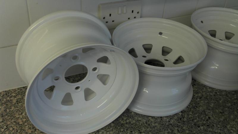

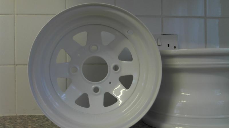

These where the wellers we had blasted and coated at a local firm, they did it first time, and there immaculate!  I did voice my concern over the edges not filling correctly as I had heard it can happen, the guy simply said if people know what there doing it doesn't happen.
I guess he knew what he was doing.
