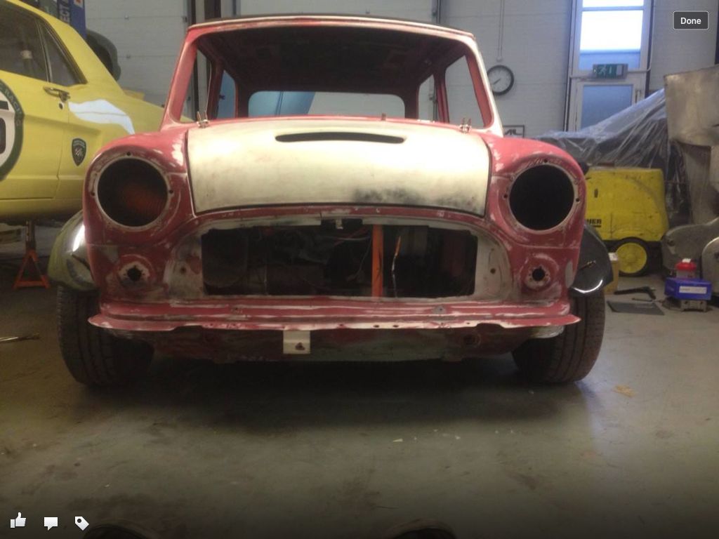

Posted 05 June 2013 - 05:32 PM
I've literally just fitted some carbon migs on mine before it left for the paintshop. I'm running 10x6 wellers with 1" spacers all round. The rear also has spaced drums on top of that... Here's a few pics...
0cc864023d5d324ab6541bc21a4fad65_zps4b8e
4eb85c02a19db81c4cc640f57b001968_zpsa812
ac91b97471e637f9dc82618741d62fff_zps8833
ce0d7a39c3a5dbb75bafbcde18f1f68a_zps00af
#14 MINIHF
MINIHF
  • 14 posts
  • Location: Kent
Posted 11 June 2013 - 02:54 PM
Looks like that will fit well! Thats for your help!
