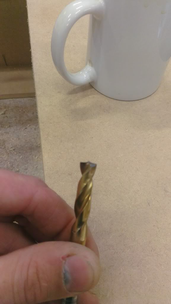

Re profile mini Darren as in......?? Okay ill have a squint ffir these colbolt drills. If not the wurth ones might get purchased. What's the reckoning lads that when I remove the bins its bad news? Marks outa 10??
I just change the angle of attack that the drill bit comes with making it more likes milling bit than a drill bit with an almost flat top with a little back cut. Sonikk is right there is no set rule to any of this work some you see better with paint on some better using a wire wheel to remove the paint and it leaves paint in the low spots that are the welds

Darren mate any chance of a pic? Well I nearly got the bugger off ran out of time tho, got to 10 pm and didn't want to upset the neighbors. Ill upload a couple of pictures. Resto thread coming up
