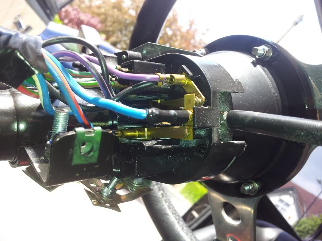

The horn - Used to work fine, worked for the MOT last year, but recently I realised it wasn't working. I've tested the earth on it and thats fine, I tested the voltage and it's only getting 0.2v from the horn wire. So unless there is some huge resistance somewhere, the wire itself can't be broken if some voltage is getting to it.
Where could the problem lie? My main beam flash (pulling stalk towards me) also doesn't work, despite the little tabs in the stalk making a good connection - could this be related?
I took the cowling off and couldn't see anything blatantly loose or not connected, it all seems nice and clean in there. Am I right in thinking the horn is the black/purple wire?

Check your fuses for the horn. I think you may find that your hazard lights don't work if the fuse to the horn has gone. 0.2v is what a lot of multimeters will just fluctuate by. If you are only getting that down it I would suspect that you have bad continuity down that wire.

  The horn and flasher are on the same fuse (the flasher is not on the same circuit as the rest of the lights) so if both have failed the problem is probably somewhere around the fuse holder.
