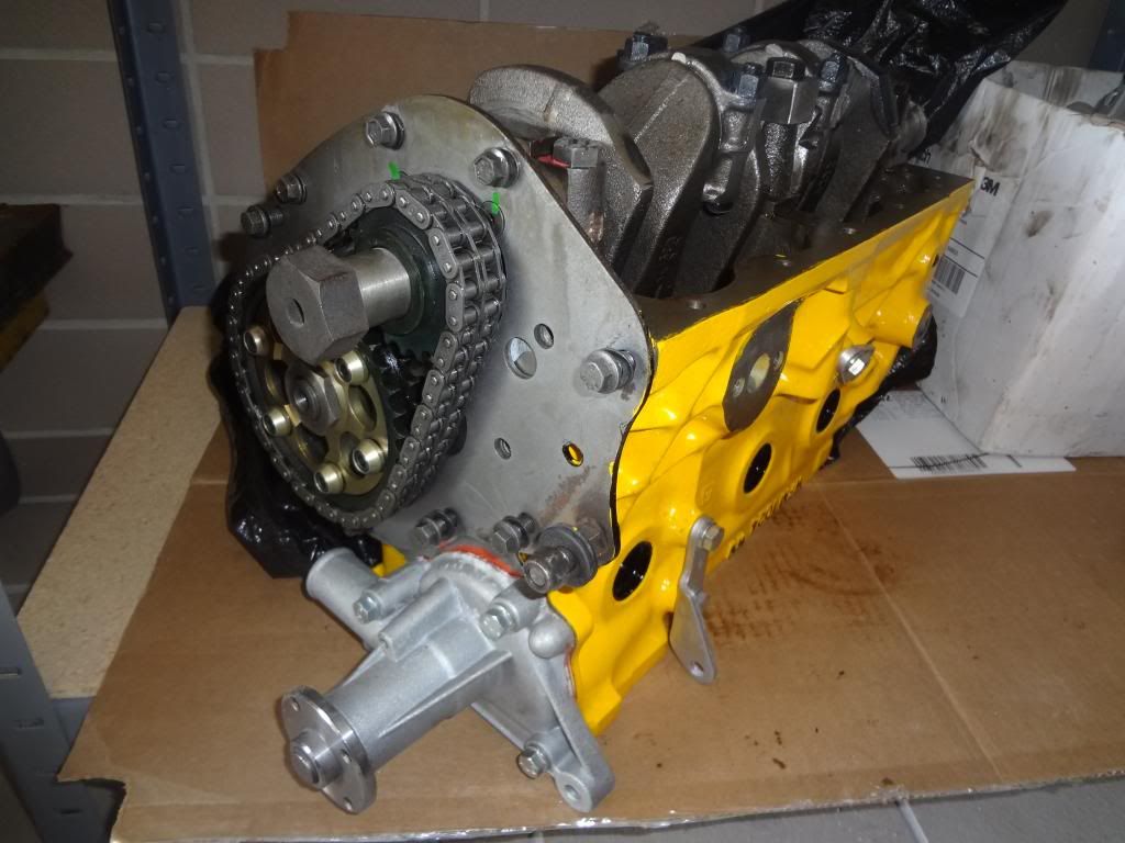

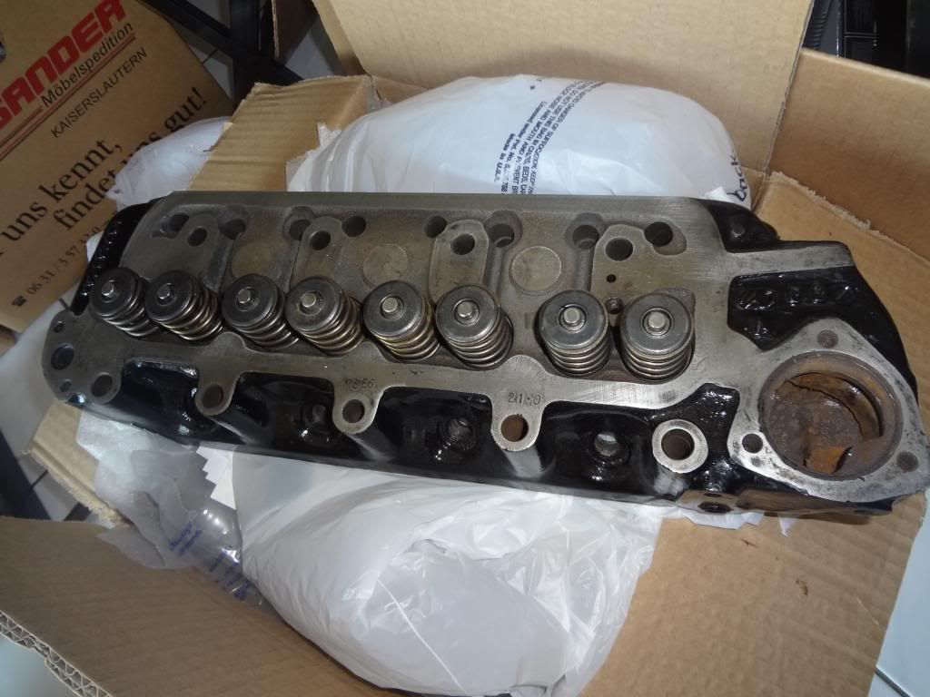

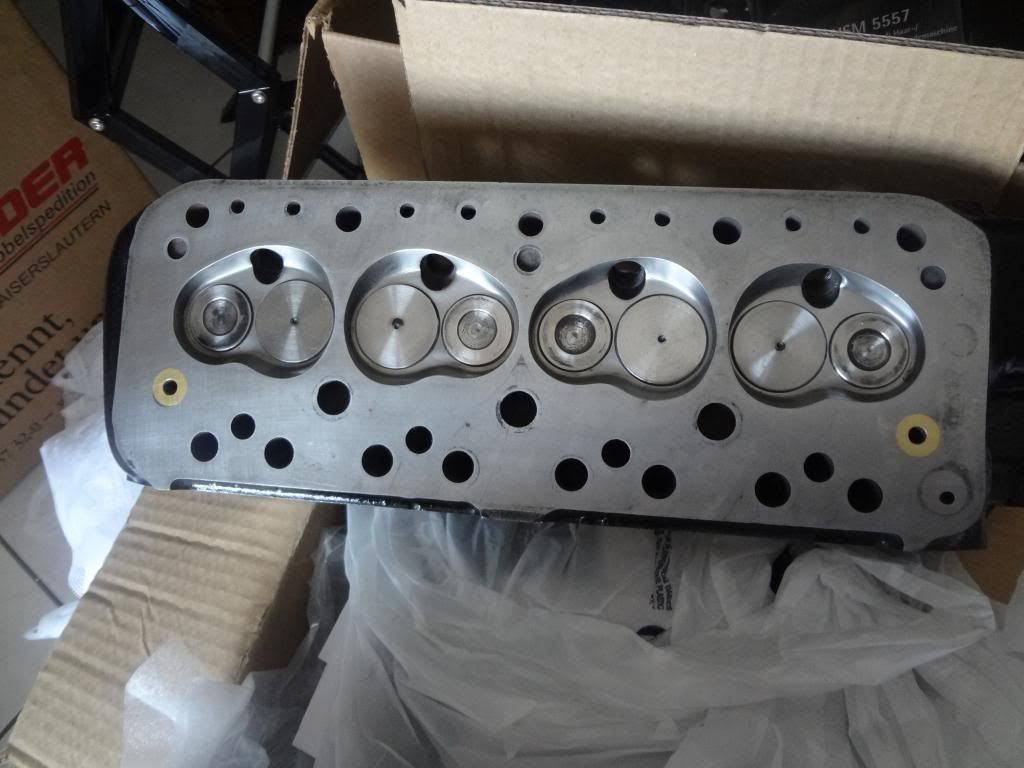

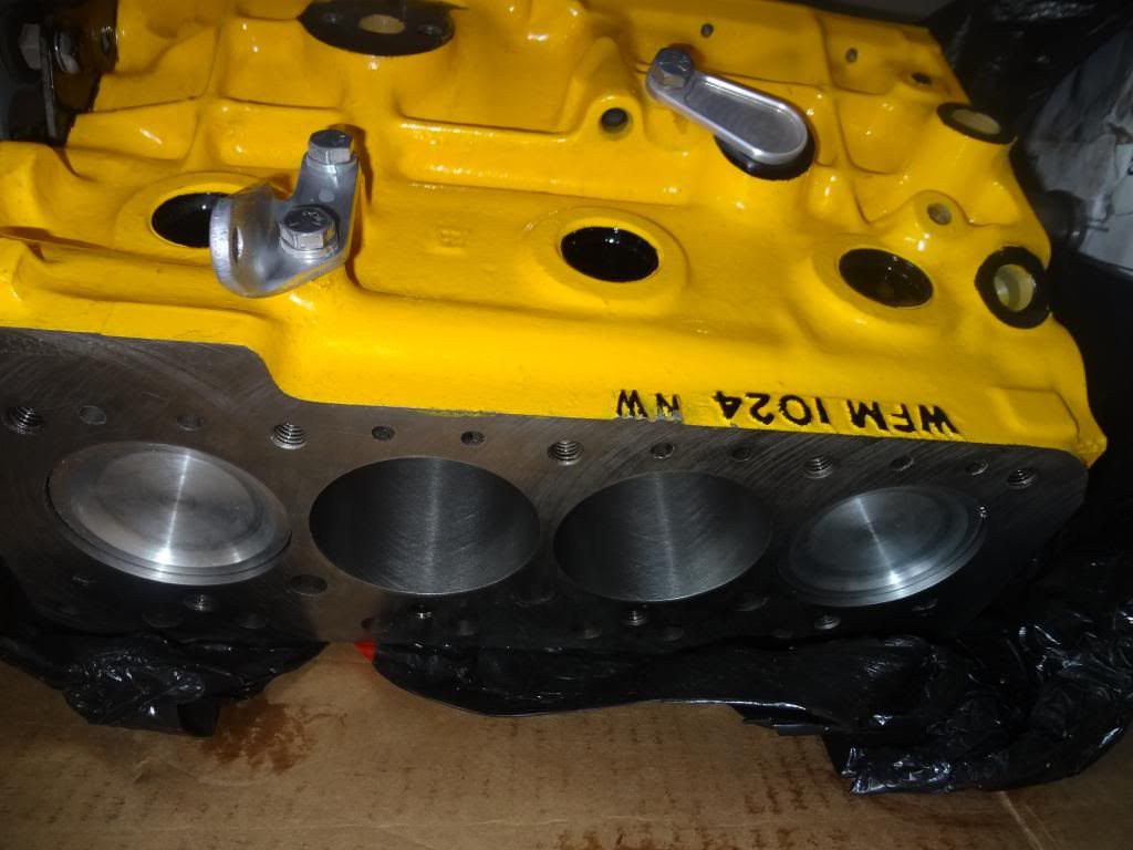

     As the title I'm building a 1310 engine to replace the current 998 in my mini.  I picked it up last year in the UK and had every intention on fully going turbo.  Only problem is when I leave Germany and ship it to the U.S for import, I cant do too much prior to its entry.  Don't want to risk it getting crushed if they think something is amiss/false.  I'll build a turbo engine after she's at home in the U.S.
    The block was rebuilt as a planned turbo'd  project and already has the 10cc dished Omega's pistons installed, center main strap, duplex chain and uprated cam(cant think of the spec of hand).  I have a Mini spares MSE6 head to use and I've did some rough calculations on the C.R and it seems to be in the 9:range. C.R. ratios are not my cup of tea.  I've searched the forum and used the formulas.  I cant find my sheet that has the exact numbers. Ill give a look tomorrow.  Does this setup seem like it will work NA versus turbo or will I possible need to change out pistons?  I have more info just late right now and figured Id get the post on to start some exchange of ideas.  gearbox/block and head are all separate at the moment.
I know it doesn't help much, but here are a few pics of the engine
Jeremy
