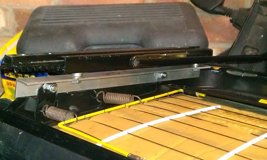

They'll go in okay on the original subframes but I found them too high for my liking as the height adjuster (ironically) takes up a lot of space, so chopped them off and used a piece of 90° alloy on some universal runners, thusly:
