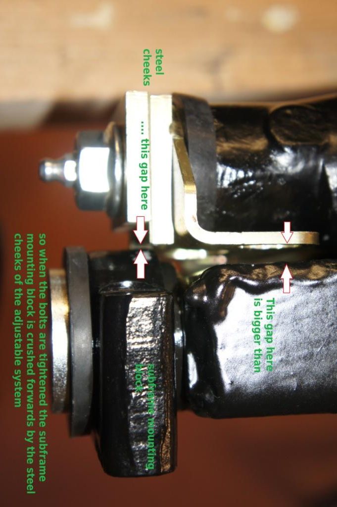

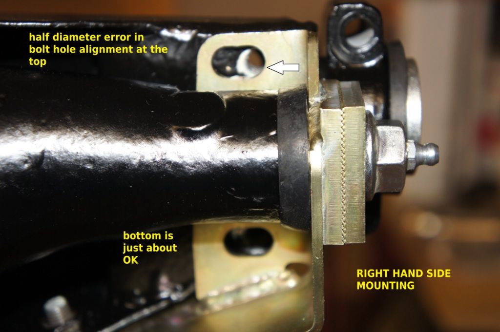

Our initial problem was that the horizontal-bolt holes into the subframe didn't line up from side-to-side, making it look like our swinging-arms were 2.50 mm and 5.40 mm too short respectively.

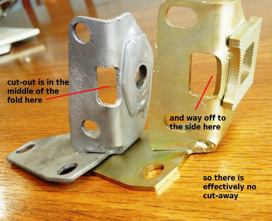

Furthermore, even if we you accepted that (and got out a rat-tailed file), there was insufficient cutaway for the trunnions and the trunnion-rubber.
As soon as you began to tighten up the fixings, the camber-brackets hit the trunnions and began to crush the rubbers.
After the usual non-reply to emails and people being too busy on the 'phone to take your call, we're told "it's because the trunnion rubbers are on the wrong way round" - which upon reflection is total ******* but helps play for time.

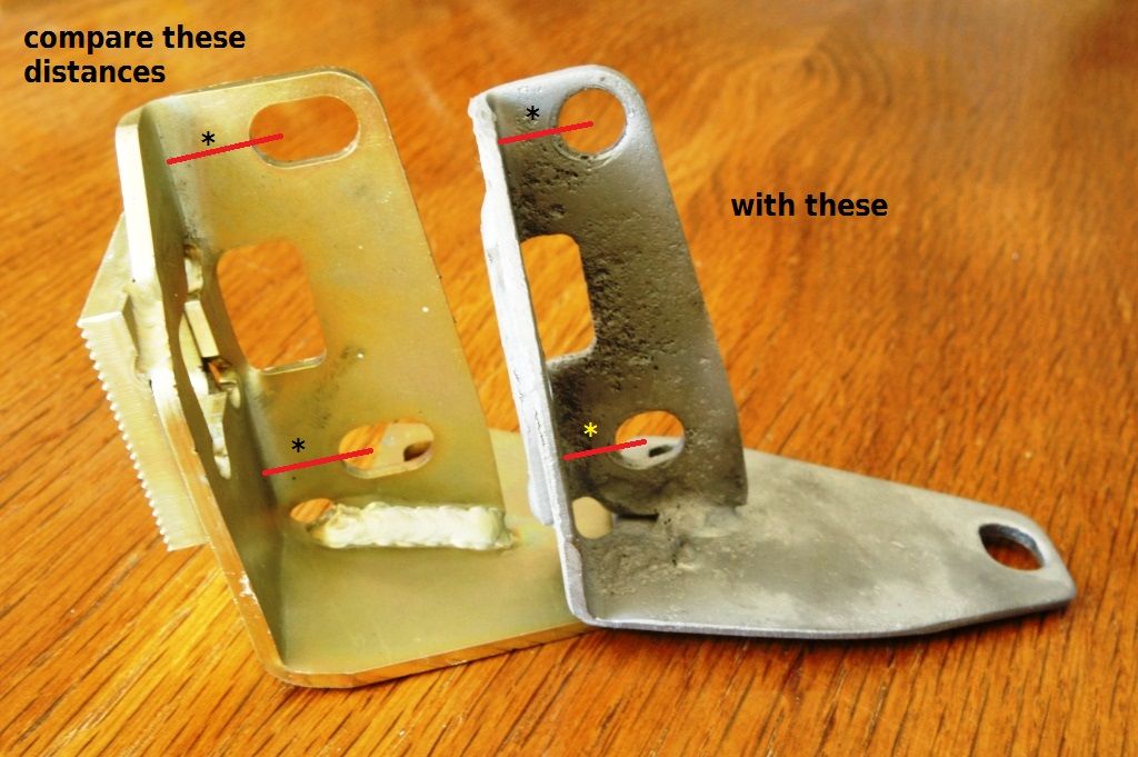

Subsequently we lay the "high-performance" parts alongside the standard ones, and you can see that there isn't a hope-in-hell of these brackets ever fitting.
