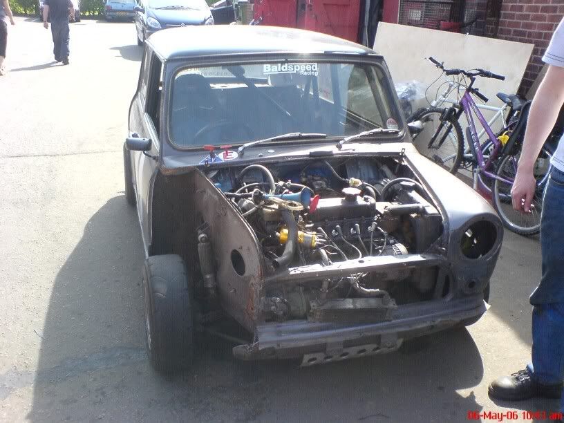

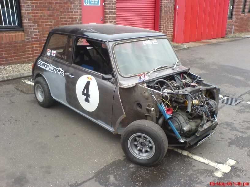

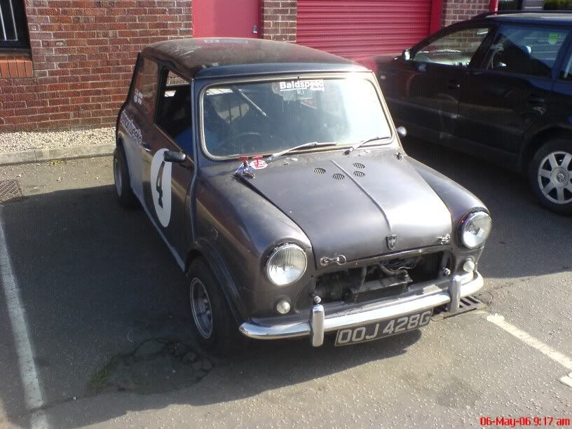

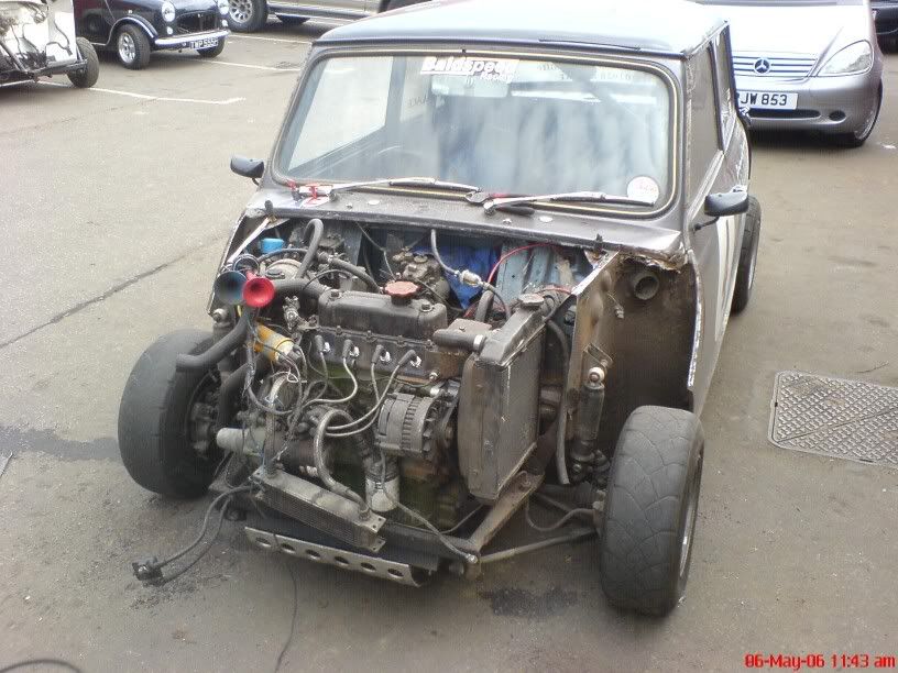

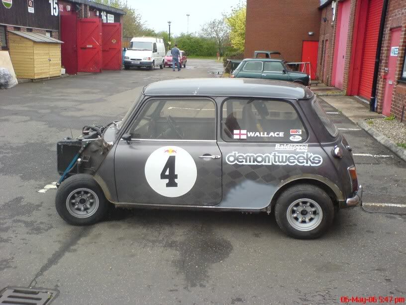

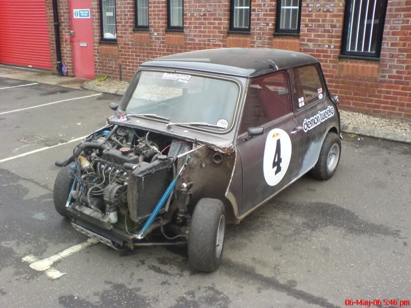

Here are some pics from my car cutting the front end off ready for a fibreglass front end.
before
front wing off
front end just off
different angles with brace bars fitted

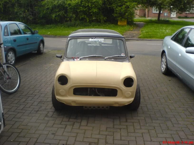

Front end just dropped on, it needs a fair bit of work to line up

Cheers, the problem I am facing with mine is that it lines up on one side but there is a gap between the A panel of 2 inches on the other. I am going to a bit of trimming to see if I can line her the front a bit better. If not I will be doing a solid steel flip front with detachable bonnet. Just pricing the panels up at the mo, just in case : (.

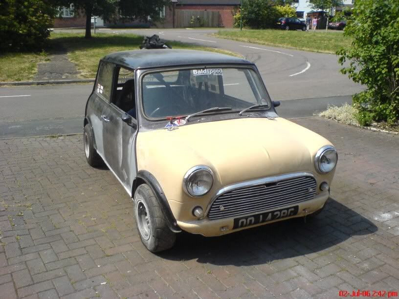

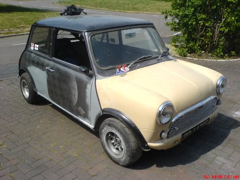

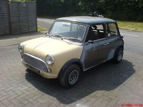

Here are some update pics of my car from the weekend
Im getting there, ive ordered my paint today so the ball is rolling on the respray front.

superb work. took me a best part of a month to fit mine. was never happy with the fitment. mine was a 2 piece front but i also had the problem with one side being slightly longer than the other! heres how it looks now. yours should look alot better with some paint on it!

Alrite Joe, I was going to email you some update pics. Yeh gotthe front end looking better, still needs a nip ad tuck here and there but I am going to get the car sat right first and go from there. The main thing why the front end was not lining up was the oil cooler getting inthe way so a quick trim on the front gave me more room and to be honest its looking a lot better.
Just got to weld another tab of the a panel for the dzus fasteners, wire the front up and I am fully done, ready for an MOT after I swapped my tyres of course :w00t:
