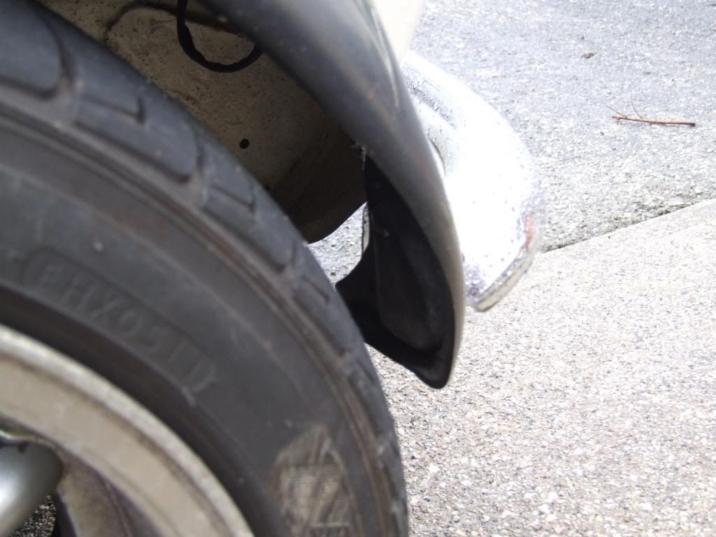

on the front offside of mini, the tyre is rubbing the fitted  arch where it meets the bumper on full left hand lock,this doesnt happen on full right lock on the nearside,panels have been cut so they arnt meeting there,the wheels are 13x7 deepdish with yoko A539.
am going to be fitting sportspack arches next week so will the bumper have to be modified or can the wheel be adjusted to make the clearance

its 94 cooper, the panels  have been cut so the tyre wont even get close ,the end of the bumper is covered by the fitted arch this is where  the tyre is touching

its got new heavy duty tiebars fitted before i got car,and high lows front and rear , have tried posting a photo but it wont let me again gggrrrr

[/URL]">http://arch001_zps3ab5b7ed.jpg PHOTOOOOOOOOOOOO YAHOOOOO

i had this problem with my sportspack arches. i solved it by basically stretching the front of the arch forward and away from the tire, then i clamped it and fibreglassed behind it so it wouldstay there.
bit of a tricky method, but worked for me. by the way i also had to cut the ends of the bumper shorter

could it be that drivers wheel is an inch closer to the front or car is twisted!!!???

do you mean the drivers side is an inch closer than the passengers side?          Bent tie rod?

it would seem that it is .only a rough measure though need to get on and get wheel off ,the tie rods look good though

looks like i have adjustable tiebars so gona get bodyshop man to do the deed and shud be ok after that ,fingers crossed!

Adjusting the tie bares for tie clearance if not what they were designed for, as the length of the tie bar effects the caster angle. the adjustable ones enable both sides to be set the same on both sides.
The mini was only ever designed for skinny 10" wheels, the problems come when you try fitting any 12 or 13" wheel that's wider than 5.5 to 6 inches. Trimming the arches and raising the suspension slightly is the way rover got round the problem...

just dropped the mini to bodyshop ,they said the will do some measurements and sort problem out ,they are professionals!!!

where are those arches from? I never had that issue with sportspacks and I ran 13x8j rims.

i dont know the was on car when i got it ,they are in poor nik so i have replaced with genuine sportpack,that should solve it.see pic for latest !!
