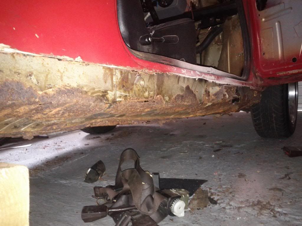

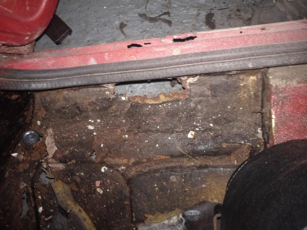

hi all i basically need to replace both front and rear floor pans on the drivers side new door step and both inner and outer sills! (a lot i know!) in which order would people do this? i was thinking floor pans, then door step, then inner sill then the outer? sound about right to everyone that?

I would do the door step first as everything welds to this.
Then inner sills however are you doing full inner sills are partial replacement. If you are using a repair panel for the inner sill these are not very good as they do not go under the crossmember.
If its a full length repair then use the inner sill from M Machine. Then go onto the floors.

cheers for the reply sonikk4 ill be doing a full inner sill replacement! just been out for a nose at it! it needs the lot replacing! id love to know why only half of the car is totally rotted! all drivers side has pretty much had it!
im only replacing the door step due to there being no lip from the rear arch to the front!

this the part you recomend sonikk4      11.31.04.37 Floor Inner Sill to First Groove, LH, Mk1-5        no vat £29.50    inc vat  £35.40
Hi yes that would be the one. If the rust has gone past the fold on the inner sill then you will need that one.
