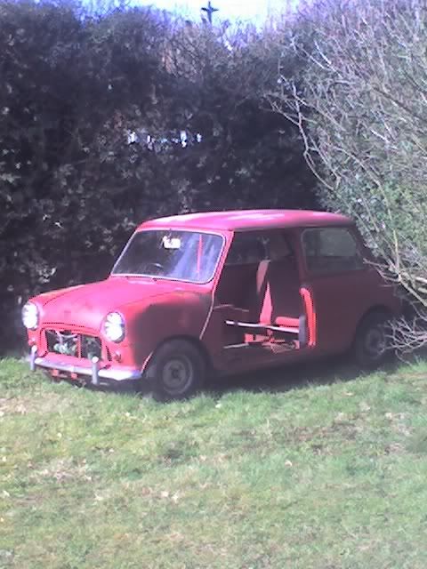

My early July 1967 MK1 Austin Super de Luxe started life as a 1275 Auto.
It changed hands several times and the second to last owner decided to change the auto engine and box to a 998 engine fitted with a 1128 gearbox but never finished the conversion.
The last owner prior me bought the car, partially stripped it with the intentions of restoring it and gave up.
The car then passed onto me, and I have just spent the last 6 years restoring the car.
The car is still fitted with the 998 engine although rebuilt as is the 1128 gearbox fitted with a 3.7 fd (64/17) and a standard 22g927 lay gear.
