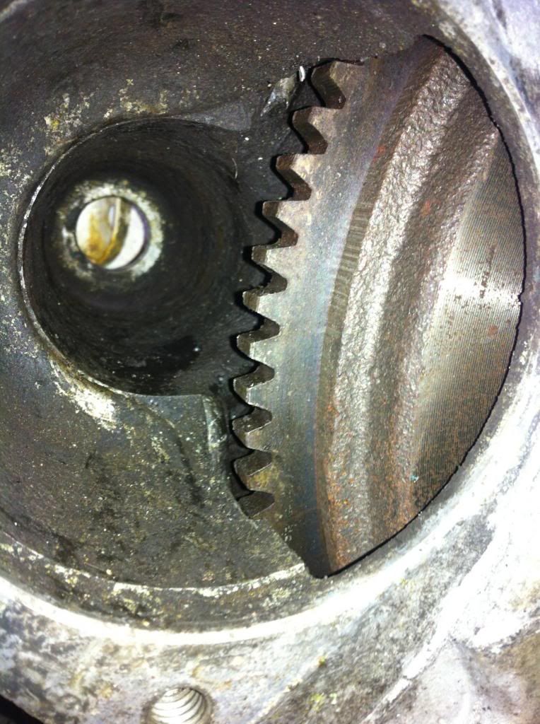

Ive cleaned all the earths and fitted a new battery with higher cranking amps still the same problem. Heres a picture of the flywheel:

Yes looks like a inertia ring gear alright, is the bendix clean and free to rotate fully? sometines the starter get weak and wont spin fast enough this couls be bad connections or a lazy starter as Yoda pointed out above
