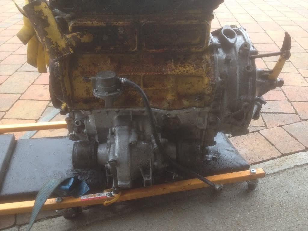

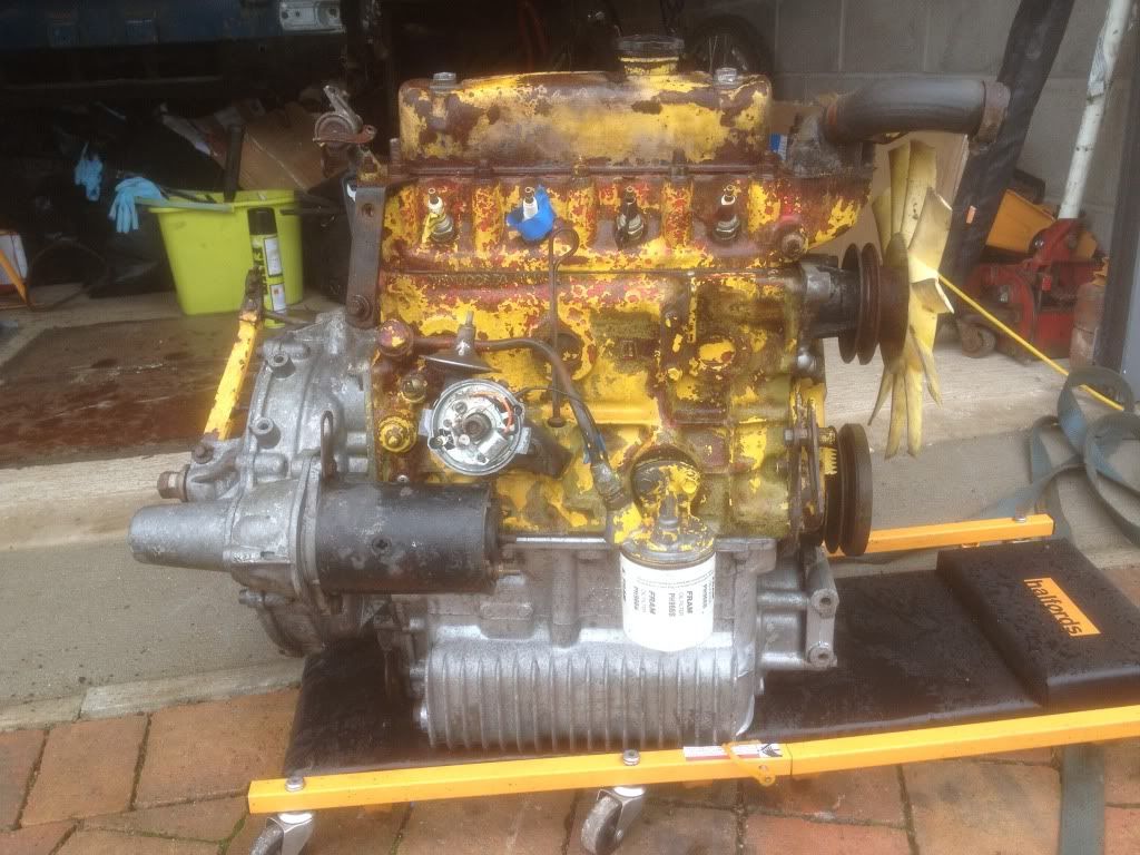

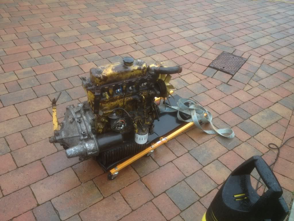

Right guys, started stripping the 1098 engine down, i degreased and powerwashed the whole engine down.
i think the Engine number is : WFM 1026/4 NWX
and i think the head number is : CAM4510 or 4810 or 4610 i cant quite make the second number out :/
bores are clean, good compression turning her over by hand, once i washed her i removed the head. ALL the studs came out lol!!
i bought a tin of red engine paint (should help it go faster FACT!!)
6AA77674-869E-4AC3-9A53-1BDAB54736FA-510
After...
12722317-C7F8-4402-A39F-7444814CE506-510
711CECC5-0EE3-4F06-B9B2-78F472B3B37C-510
im not sure how to check the clutch... and im not sure if this engine is compatable yet or unleaded orverto/prevert0... ive got research to do!!
Filbey

The "WFM" number is the block casting number not the engine number, that will be on the small metal plate on the flat surface under the temperature sender next to the water pump.
It's definitely a small bore unit, looks to be A+ and definitely a pre-verto clutch, so I'd say circa 1979-1983.
