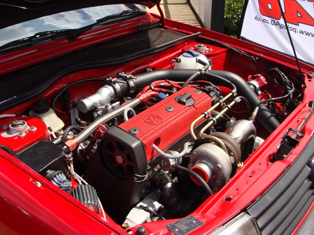

Done right they end up VERY nice,
Here's a guys turbo g40 polo off another forum

#4 Tamworthbay
Tamworthbay
  • 7,025 posts
  • Name: Clive
  • Location: Tamworth
  • Local Club: A5 minis
Posted 09 November 2013 - 08:19 PM
Here's a guys turbo g40 polo off another forum5a3dd4301f4dc4e664d1ca23c7619f10_zpsdb95
That's exactly the finish I am looking for. Just wondering whether its possible with eBay rattle cans or not.
