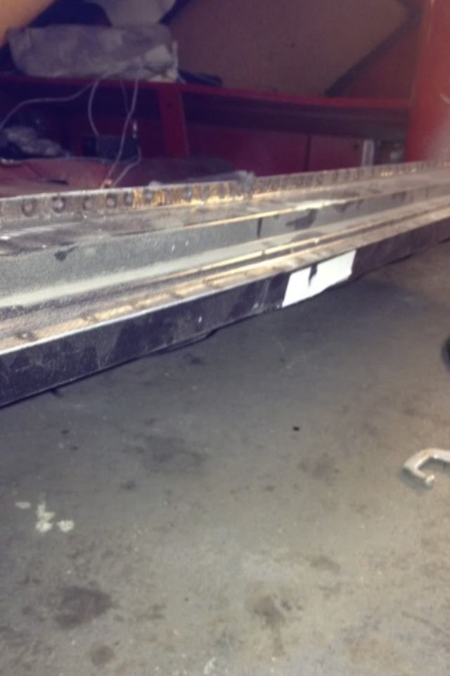

Posted 10 November 2013 - 10:44 PM
I always use plug welding like this on my estate
Dan
