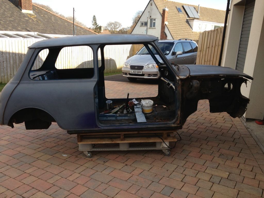

once you have the engine and subframe out a pallet with some castors on will allow you to roll it about still... welcome to The Mental Farm

you can see how mine is under the whole car you could do this or just the front end ??
