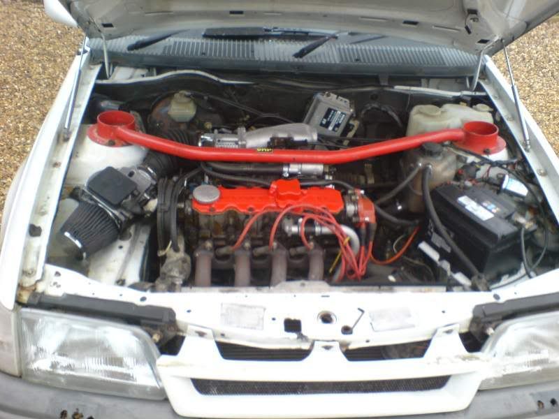

Posted 03 January 2014 - 03:08 PM
hi just to let you no this is the engine i am going for. come to a deal and had all the parts i need just waiting for it to be removed and i will be going to fetch it. i suppose this engine will fit under a round nose easier then a redtop? thanks tom
#6 DanParsons
DanParsons
  • 135 posts
Posted 03 January 2014 - 06:40 PM
Completely depends on year of engine and condition etc, wouldn't pay a lot though as they are fairly easy to find, yes as the physical size is smaller
