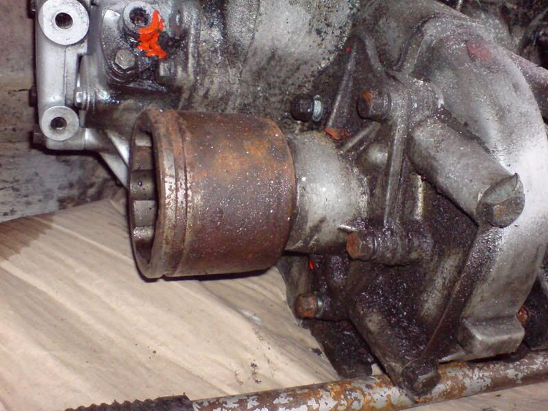

hi have purchased a set of 7.5 discs however they have this end on them : the question is how do i fit that onto my diff which has these types of connectors on them
this is how my drum driveshafts look

use your drive shafts but change the CV joints for the ones off the 7.5 disc set up...
CV is the joint on the right in your bottom picture

The yoke coupling driveshafts are of a different design to the pot joint ones, and are not interchangeable.
I'd knock the CV joints off both and fit the disc ones to your existing driveshafts with a pair of shiny new boots.

that's what I said :)
