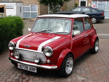

Posted 31 May 2006 - 08:31 PM
you dont need to make any alterations to the steering rack whatsoever.
agreed. i didn't :D Posted Image
