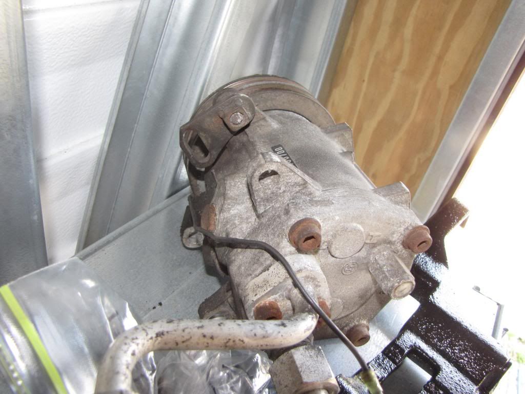

#6 xrocketengineer
xrocketengineer
    Rocket Man
  • 1,637 posts
  • Location: Florida, USA
Posted 12 February 2014 - 09:12 PM
First of all, the factory air conditioning cars were SPI and not MPI. The MPI with the radiator up front has no room for the compressor. As freaker said, the brackets for the compressor and alternator for the Japanese car are the key. The compressor bracket attaches to the regular attach points for the alternator on the block and the water pump. The belt from the crank and water pump drive the compressor on the outer groove of the pulley.  The compressor pulley inner groove drives the alternator with a very short belt.
The compressor bracket also has the tensioner pulley for compressor belt.
The alternator pivot bracket attaches to the two extended length head studs close to the thermostat with a second nut.
The compressor has a small bracket with a slot for the adjustment of the alternator belt tension.

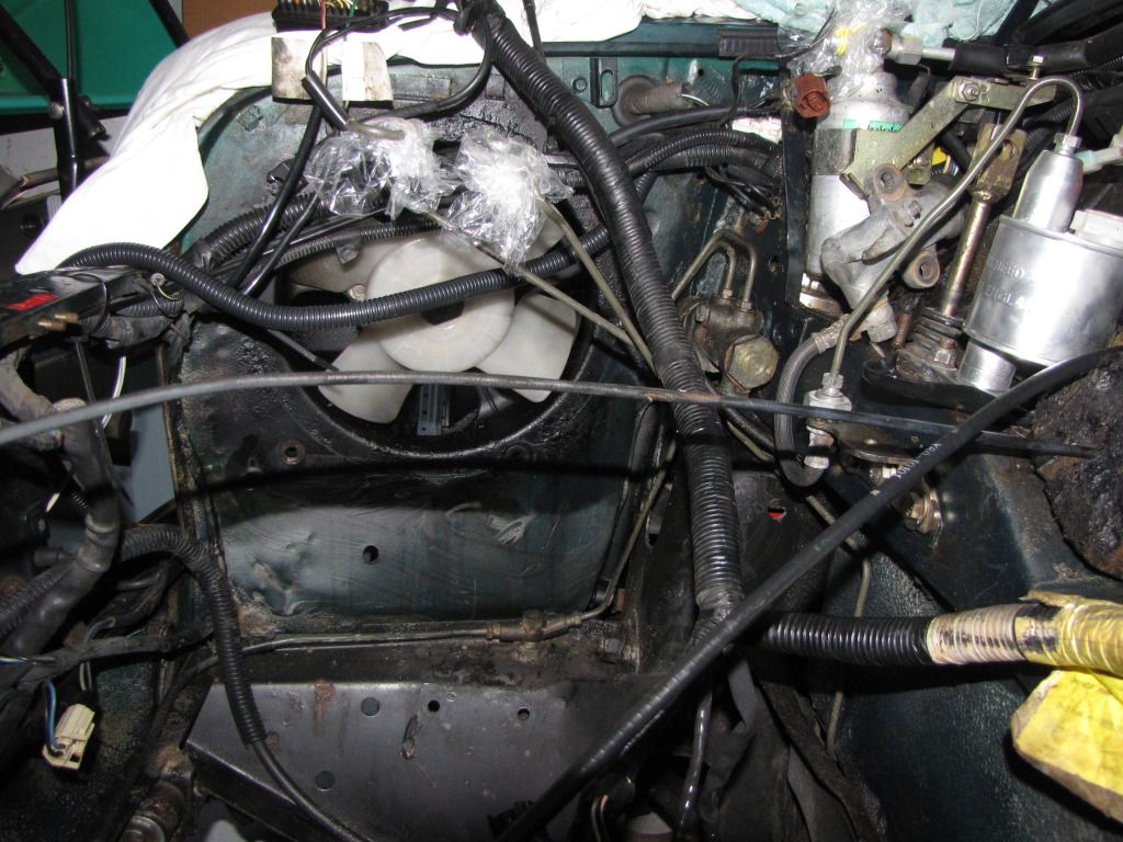

Posted 15 February 2014 - 01:42 AM
Brilliant. What a great post with some fantastic photos. Really appreciated.
To clarify, are you saying I can only fit AC to an SPI?
Also, you mention the bracket specifically, but not the compressor. Can I use a different, equally small, compressor from a different manufacturer, as long as I can make the bracket fit (like the one from carbuildersolutions) or do I also need the jap compressor?
Finally, where would the condenser/fan assembly fit in an SPI...inside the wing...and again do I need the jap condenser?

Posted 15 February 2014 - 03:31 PM
Any small Japanese compressor that fits on the bracket should be OK I think. The condenser on mine is located on the right inner wing with a fan inside the the wing. The ECU is relocated behind the grille.
On some earlier models the condenser and the ECU have swapped locations.
Edited by xrocketengineer, 15 February 2014 - 03:32 PM.
