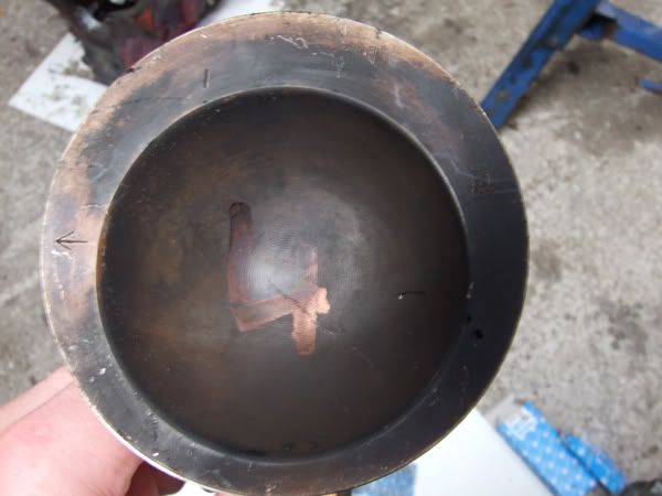

Rebuilding engine, all info on piston crowns the same timing chain end 71.578 ,Sp 0.05 clutch end ,on all four. On the underside of piston looks like No2 180 degrees out, number on bottom 070 149 clutch end on 1,3 and 4 but on timing chain end on No2 (upside down though) Whats right crown info or underside info or nothing to worry about ?
  • Attached File  013.JPG   27.64K   9 downloads
  • Attached File  014.JPG   27.44K   6 downloads
  • Attached File  022.JPG   26.71K   7 downloads

Thanks, all the info on tops of pistons read the same way round (left to right looking at engine from front). Engine been honed and crank polish, new shells and rings fitted, all turns over ok. Just from under side No2 piston look 180 degrees out to the rest or that ones right, and the other three are wrong !

You can get pistons that are offset to suit certain specifications of engines, hence some pistons are marked FRONT.
This isnt about how round the piston is, they are all round, but the piston could be dished differently to suit application.
As above.
If the piston isnt offset dished or marked front etc, it should be fine

It's my understanding that pistons are handed.  The gudgeon pin isn't actually in the centre of the piston, but offset slightly, so they should all be the same way round.

I thought they were handed as they have a thrust face
