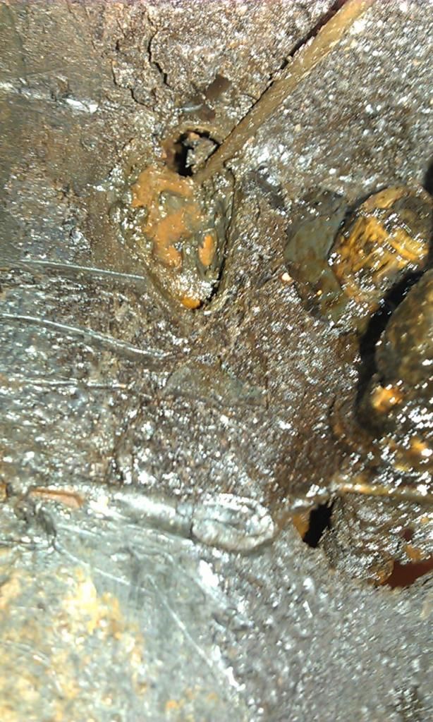

And this is the small gap that it is supposed to fit through? Sorry not a brill pic this is the gap as seen from the inside of the subby.

Where that small hole is should be a much larger gap. It looks as though it is blocked up with something. Crack out the wire brush and a pressure washer if you have one.

Believe or not this is after I pressure washed it with my Karcher 110 Bar Pressure Washer.

This is the best image I can find that shows the holes in the side for the cable to pass through.
http://blog.minispor...rameWelding.jpg
(taken from google images)
It still looks like there is something wedged in that hole.

The triangle shaped hole where the cable goes through is plugged up with rust/grease/dirt. Tap around the cable with a drift to open the hole up then it should go through. Man that's plugged good and proper.

Just had another look in the cold light of day, the subby is on the ground at the moment upside down. That orange thing blocking the gap was actually the radius arm, once I sat on the hub and applied some pressure the radius arm cleared the gap sufficiently to prise out the handbrake cable.
