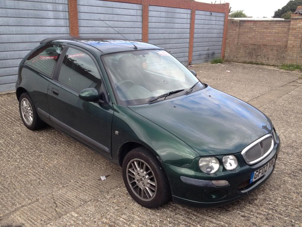

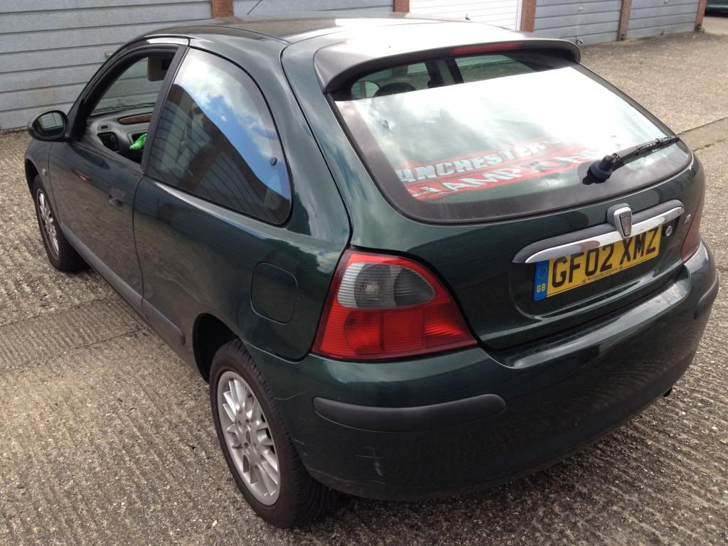

Named by the gf, its my BRG Rover 25. While its a bit old and battered, I quite like the car and its a great workhorse and you can fit a surprising amount of stuff in it with the rear seats down. It does have quite a few little issues though.
  • Near side CV gaiter split.
  • Occasionally losing coolant.
  • Huge dent in drivers door. Narrow entrance to parking, and a coupe of homeless people laying on the floor who I tried to avoid, and made contact with the wall.
  • Driver's electric window doesn't work. The switch has been disconnected because the mechanism is bent and causes problems.
  • Driver's door speaker doesn't work.
  • Hole in the boot, looks like someone has removed a grommet or something.
  • I am sure the driver's window is leaking as well, the car is always steamed up and the seal doesn't look great.
  • Clock doesn't work.
  • Gear stick gaitor missing and the clips on centre console have snapped.
  • Heater only works on number 4. Easy fix.
  • Rust on both front wings, minor but needs treating sooner rather than later.
  • Carpet is dingy. Needs a good clean or replacing.
  • Stereo is old and knackered. Radio doesn't work, CDs skip a lot and the USB doesn't work.
  • ******* doesn't work. EDIT - Don't know what it doesn't like here. But something I can't remember doesn't work!!
  • Seems like only one light in centre console switches and dials works.
  • Air con doesn't work.
  • Boot floor liner is rubbish and has no strength to it.
  • Creaking suspension at rear.
  • Central dash vents falling apart!
  • Near side headlight points quite low and I think needs demising as well.
  • Full service
So there is a lot of little things to get sorted. I am going to try and do most of it over the next few days. I have built up a little money in the PayPal account so that should cover most of the bits I need. A quick trip to the local scrappy usually turns up a few useful bits. I have nothing else to do until my job interviews but my only major issue is the garage has no power and is damp (I'm only renting it so trying to sort out damp issues might be fun). Its also a few miles away, so I either need to make sure the car can still be driven at all times or lock it up and cycle to and from until its done. I have a couple more things to try and sell to bolster the funds just a little bit more, a new stereo and speakers can wait until the end and aren't a huge rush though. Economically I know I will never turn a profit on it, but it only cost me £600 and despite these issues, sailed through the last MOT, with the CV gaiter being the only advisory. I've grown quite fond of the little thing. It will only end up being stripped and sold for parts if I don't fix it up.
Here are a couple of pics of it:
 This is before the door was dented!
Like I say, nothing special at all but I like it and its something to do!
