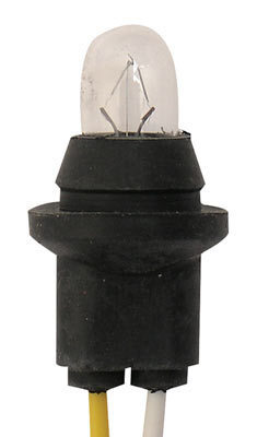

I don't fancy paying £33 plus postage on a wiring loom I can make myself haha.
Found these which are cheap, no idea if they'll fit in the holder though, i'll buy one and test it
