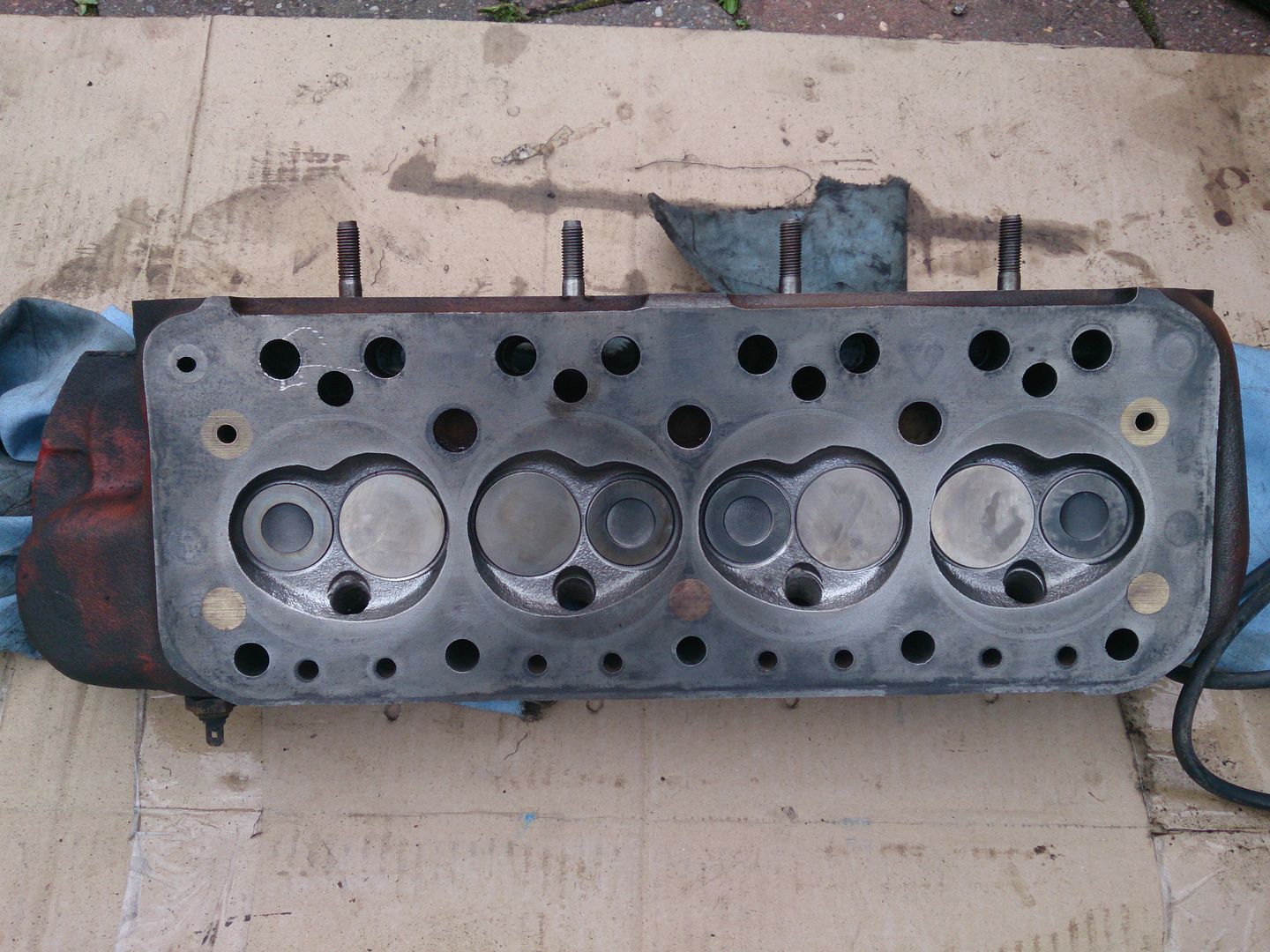

It's an Iron engine so a decent wire brush on a drill!
DSC_1484_zps6e0c99c8.jpg[/URL]

I used an industrial steam cleaner on mine
of course not available to everyone but it certainly did the job!

Creating a uneven surface,scratches,... seems legit...
Oven cleaner worked for me by the way ;)

blasting

I'm used to clean with paint thinner then wire brush on the chambers when i strip the cylinder head down, i do this every year.

A guy at work sprayed it with WD40 and left it overnight, in the morning he rinsed it and it came up spotless. I wouldn't have believed it unless I'd seen it with my own eyes!

I have used Swafega Jizer and a stiff brush (washing up brush or similar) spray on Jizer, work in, then use a steam cleaner
Best technique I have found is the a-series steam cleaner. Head gasket went on one cyl and it ended up leaking coolant into that cyl, when I took the head off it was unbelievably clean on that one cyl! perfectly spotless!
