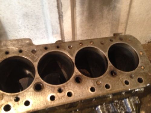

Hello guys.
I've been looking on a well known internet auction site, to accumulate parts for an engine build that I'm going to undertake.
I have been looking at getting a 1275cc engine and 'box in whatever state I can get my hands on, then stripping it down and rebuilding it.
However, I spotted a block that has already been overbored to accept larger pistons, and I was initially tempted to bid, however, the wall between 2 & 3 looks pretty thin to me, as this is a common failure point, I thought I would check with the great and the good before committing to a bid.
I know that cylinders can be offset when going for a large rebore, is this something you are able to see with the eye, or is the offset in thou?
Thanks,
Matt

I would aim for a block that can take another overbore. Once that one is worn it's not easy to sleeve.
You can bore a 1275 lump +20, 30 &60 without offset boring and can sleeve it back to standard.

It doesn't 'look' offset bored to me to be honest.
Anyway, I wouldn't buy a block at 73.5mm with the intention of rebuilding it.  I'd be finding one that I knew needed work but was close to standard bore.  There's nowhere left to go with that block other than liners.  I'm not saying it's a write-off, but it's not the best option IMO.

I would never buy a block that has been bored to accept 1380 pistons.
First of all it may not have been 'offset bored' in which case there will be constant problems with head gaskets. Secondly it may not be possible to bore further without the expense of special cylinder liners. Thirdly, unless it is a fresh re-bore, it may in fact be virtually scrap as it is.
The risk outweighs the 3 or 4 extra bhp which a 1380 will give over a 1330.

Posted 17 March 2014 - 09:54 PM
The Matt and Cooperman, thanks for the advice, I was just having a poke around, what you say makes perfect sense - that block is in no way a known quantity, so I'll avoid it. I am going to be building up a unit with the Specialist Components 7 port billet aluminium head and fuel injection system, the specs they have on their site have the head mated to a 1380 block with a CalverST RE13 cam which developed about 120bhp, and 100lbft of torque.
Whereas the reduction in BHP maybe nominal for between 1330 and 1380, I don't know what the effect dropping the displacement will have on the torque output. I'd rather stick with the specs that they've put together.
