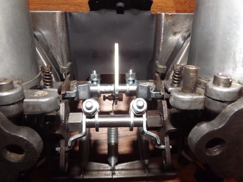

You will most likely need different needles for your engine. It is pretty much impossible to tell you which needles you will need; and I'm sure a lot of people on here, including myself would suggest you get it rolling roaded to get the best out of them.
Here are a few photos of the ones I have just built up.

Thanks for the photos stiggytoo, they help out a lot :)

Thanks for the photos Stiggy it saved having to ask my question! :)

The inlet manifold in the picture above is not a Mini one!
That indeed does appear to be the case.  The picture in post #5 above shows 12G242 as the manifold casting number.  I have seen that manifold listed for a couple of non-Mini applications including MG-Midget/AH-Sprite (inline A-Series).
Thanks for that guys.
