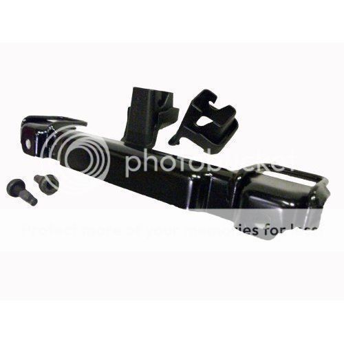

Yes mate,
This is the Ford retro fit unit
I'm not sure about using one of the outer mounts, are they in parralel to the centre ones?
