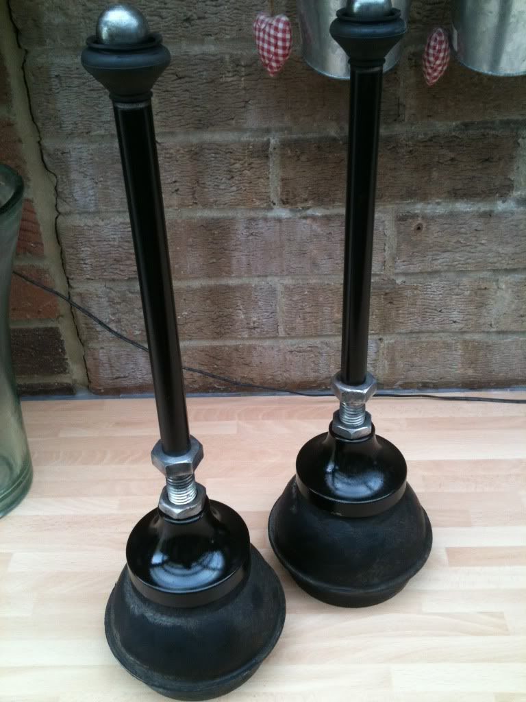

I'm not sure. I got them second hand off here. I'm pretty sure they are not adjustarides. There are them-

#6 Tamworthbay
Tamworthbay
  • 7,025 posts
  • Name: Clive
  • Location: Tamworth
  • Local Club: A5 minis
Posted 22 April 2014 - 05:11 PM
That pic looks to have them set at their longest possible position.
#7 Bungle
Bungle
    Original Spamster
  • 28,971 posts
Posted 22 April 2014 - 05:27 PM
and that lock nut isn't doing anything
#8 Cerberus
Cerberus
  • 989 posts
  • Location: near Leicester
Posted 22 April 2014 - 06:15 PM
Is it just me or do those rods look a bit long?
Might just be the photo and the fact that they're vertical rather than horizontal and not on a car, but they look longer than the rods on my rear hi-los.
#9 Tamworthbay
Tamworthbay
  • 7,025 posts
  • Name: Clive
Posted 22 April 2014 - 06:25 PM
I think that is just the pics, never seen black ones before but I assume someone has painted them.

#14 Will16
Will16
    Wants a custom member title
  • 1,090 posts
Posted 23 April 2014 - 06:18 AM
Thanks a lot guys. I think my rods are too long. My neighbour has a lathe, so may see if he can turn them down a bit.
