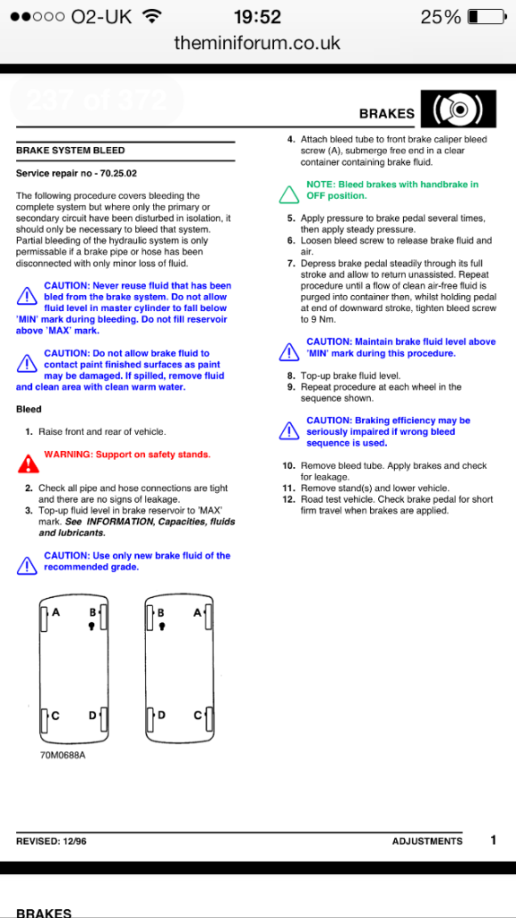

The workshop manual on page 237 shows a diagram that makes no sense however the back two are last.
can someone decipher the picture and let me know? i can't copy and past the picture in i'm afriad.

the order I gave above is how I did mine and that's from page 237, I assume its for left or right hand cars.
The size of the spanner depends on the age of the cylinder, either 1/4" af or 7mm (this is what I found anyway) try with the 1/4" first as it just wont fit rather then the 7mm that would appear to fit until it slips and rounds it off.

Posted 01 May 2014 - 06:54 PM
4BC2EB11-5835-4AC8-9030-52CFEA5477C2_zps
#9 jamesmpi
jamesmpi
  • 1,940 posts
  • Location: Chichester
Posted 01 May 2014 - 07:04 PM   Best Answer
Basically bleed the brakes in the order of A, B, C, D.
The image on the left is a RH drive car and the image on the right is a LH drive car

thanks very much, just what i needed.
