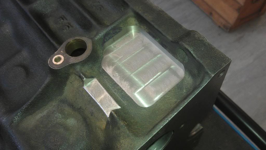

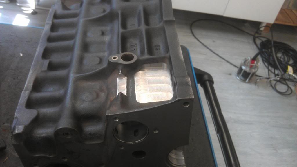

Posted 17 May 2014 - 09:03 PM
Couple of pics of the machining I did for my mates, this is an MPI block being machined for the SC oil return breather manifold.
