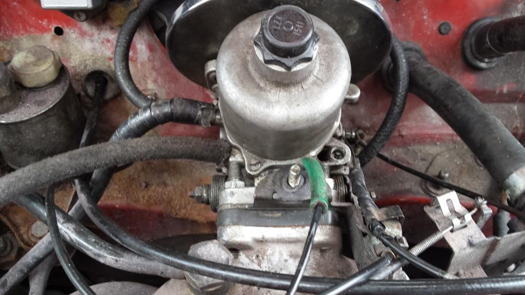

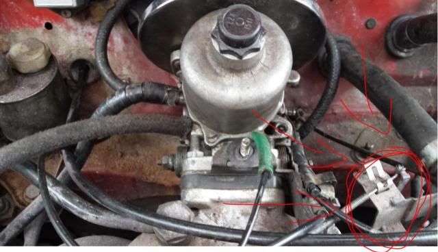

Is it possible for anyone to show me an image of where I should be looking? I have attached these of mine (not sure if they'll help)

That hose on the far right of your top picture is the heater hose, there should be a black thing with a cable attached to it.

think it is just out of shot in your photo but you can see the cable leading to it - right hand bottom corner of photo. it appears to be not connected properly. the clip should be gripping the black outer sheath  firmly to hold it steady. and the inner cable needs properly attaching, unless the outer sheath is secured then the cable wont operate the valve.
you will probably find the valve has seized open and may need repairing or replacing
