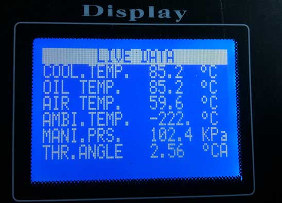

Hi gang, Long story short my old mini cooper got squashed by transit van whilst I was parked up at the lights, and I now have a very nice Mini John Cooper 1999 LE.
After saving up for A fault code reader (T-300+) and appropriate lead to talk to the Min I discovered that the ambient temperature sensor is reading -222°C.
So my question is, I know that one of the air temperature sensors is the green one, and attached to the right hand side of the engine, (which I have measured and is approximately 2.2Kohms), is this the faulty temperature sensor above, or is there another one I should be looking for? I can't seem to find mention of more than one air temperature sensor.
Thanks in advance, Bloke.

There is no ambient air temperature sensor as far as I'm aware - certainly when I used the correct tool for my MPi (SP ACR4), no ambient air temp sensor was shown, and there sure isn't one in the engine.

Okeydokey, that's a relief. I guess it must be something used on one of the other rovers in the range that use MEMS2j

Correct. It has no meaning on the mini setup.

As above it doesn't have any meaning on a mini. I have moved your post to this section so you have your own thread.
