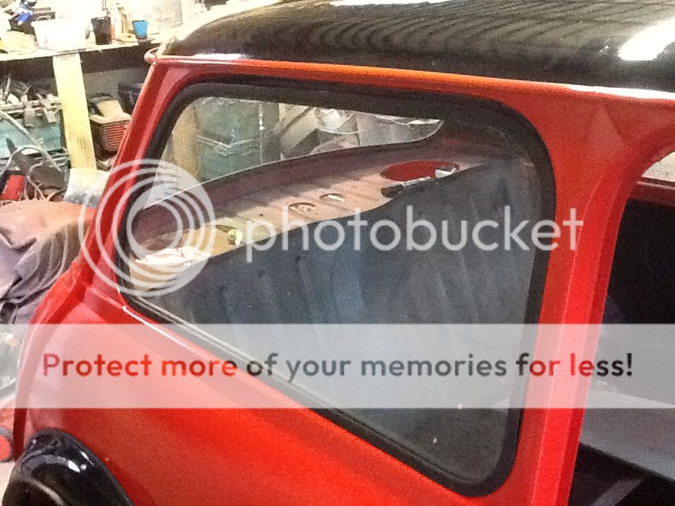

Pictured of problem.

So it looks like the glass is wrong after all, the glass I was supplied measures 34.5cm top to bottom with no rubber.

When I get back ill measure one of mine. I wonder if your Windows are the opening type but without the frame?

Posted 24 May 2014 - 11:06 AM
That's all I can think off but they was supplied with old sealed window type rubbers fitted.
