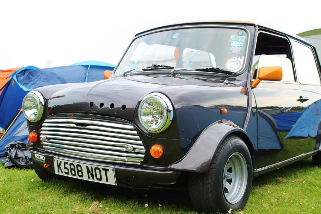

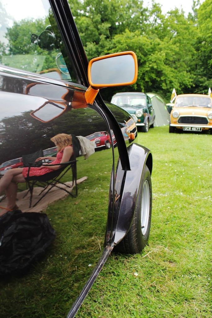

I've got 10x6 wellers under euros and they just about fill them. I'm looking at getting my set of specials split in the near future and I'll be going either 6.5 or 7. Most likely 6.5 as they'll be less stretch on the tyres then.
