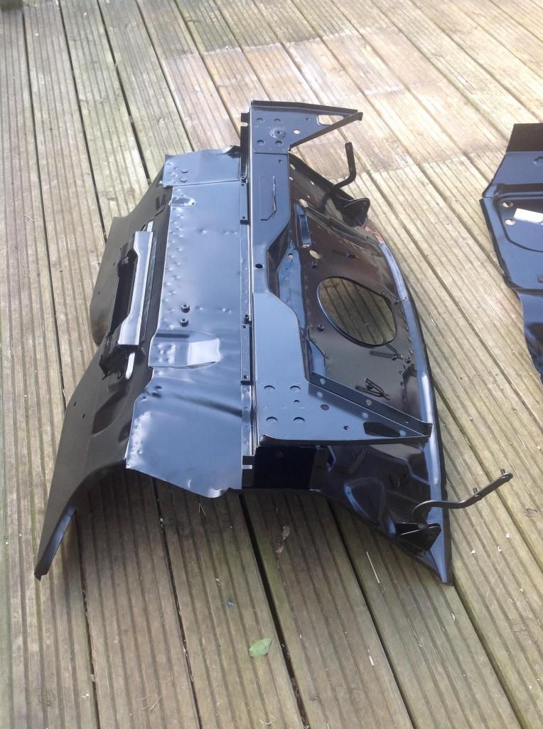

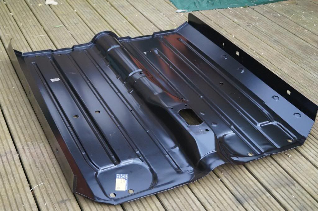

so finally an update , floor arrived from minispeed , and have just ordered the complete front bulkhead which should be here by the end of next week.
im going for genuine panels, as im hoping they will fit together better,
im also planning on fitting complete inner wings with the A panel attached , if anyone has any advice on this ?
next up is healboard and floor crossmember
oh and picked up a decent set of hi los so at least i can have adjustable suspension.

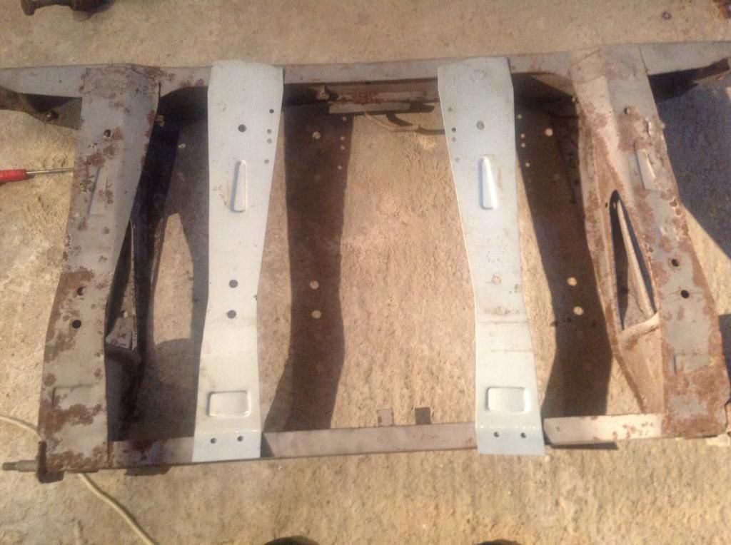

My repair panels came today for my rear subframe .
Gives me something to do !
The subframe has been blasted in the past but i would like to get it galvanised and then painted in 2k

Got a present today from minispeed !

Posted 11 September 2014 - 06:56 AM
Looks good but i don't really like the way they have fitted that rotodip conversion panel to the bulkhead.

Cheers myredmini!
I know ben , but i would rather have a panel that didnt have rust running through it , plus mine had a weber box cut into it so looks better than that !

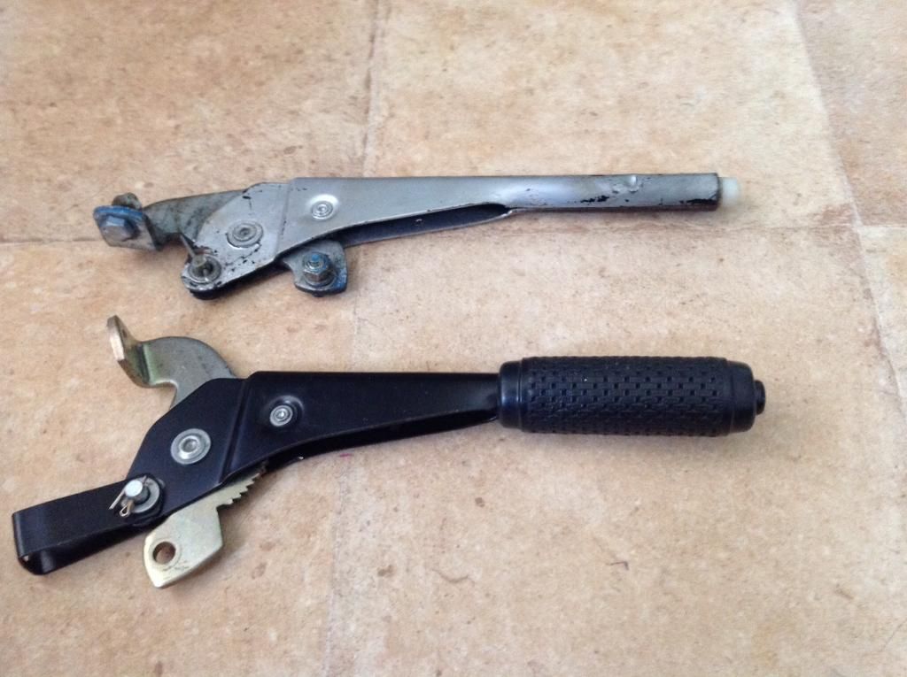

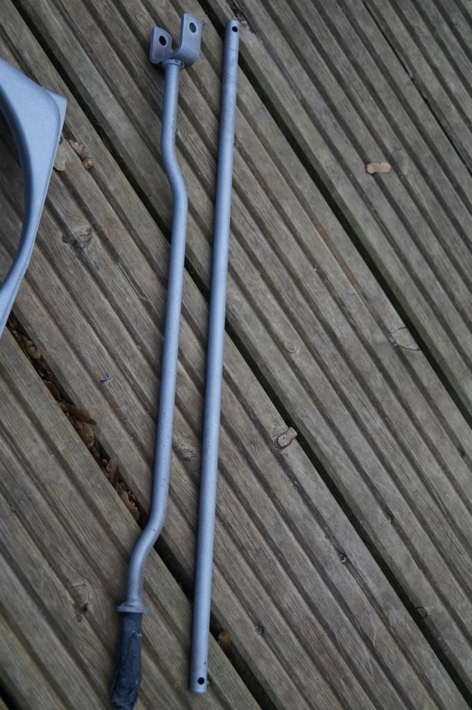

New handbrake turned up from Antony, much better than the original one !

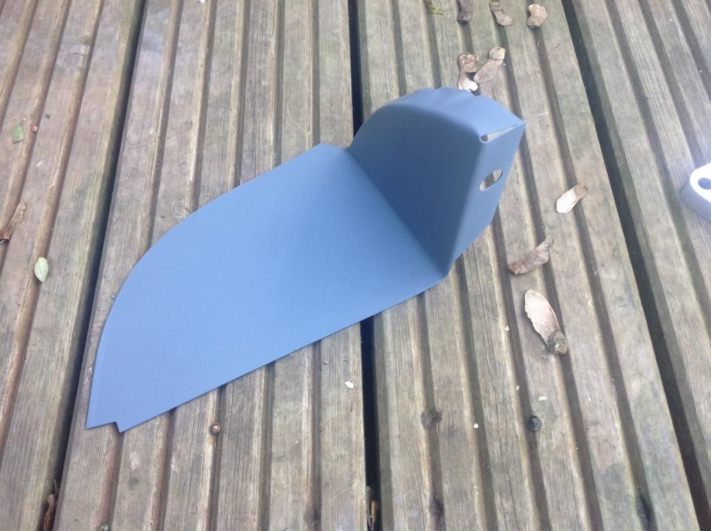

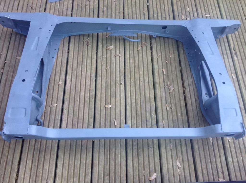

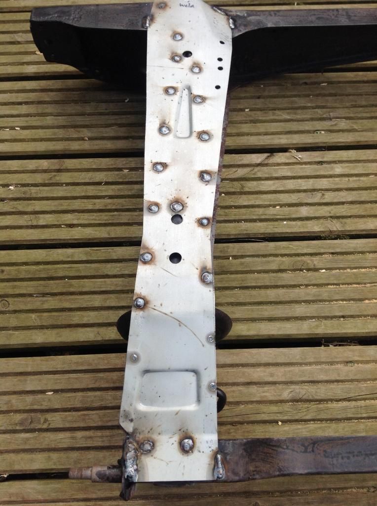

Took the left hand side panel off the subframe today, it was super clean underneth which is good !
And welded the new panel on , think im going to do the other side too, had to plug weld it on in the end as my spot welder kept tripping the house electrics !
Was going to get it galvanised but had a quote of £250 , and i would have to give it to them blasted which would cost me more money.
Now it will have a couple of coats of zinc rich primer , and two coats of 2k

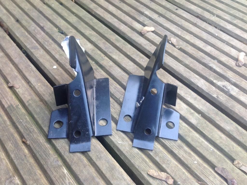

Genuine rear subframe mounting brackets for the rear

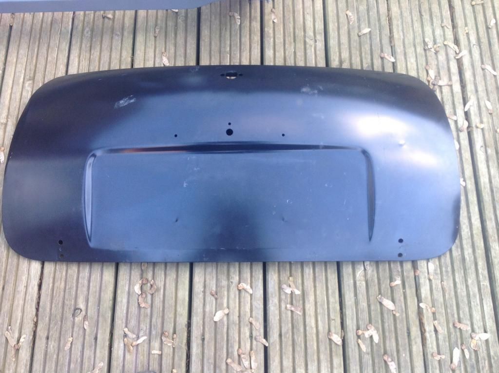

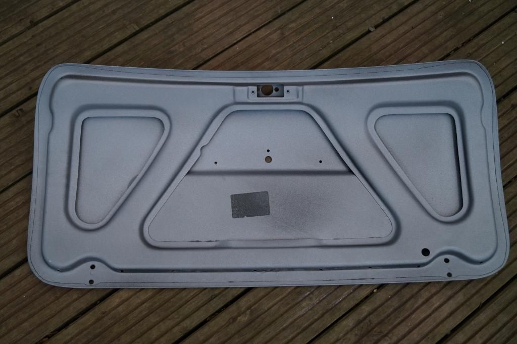

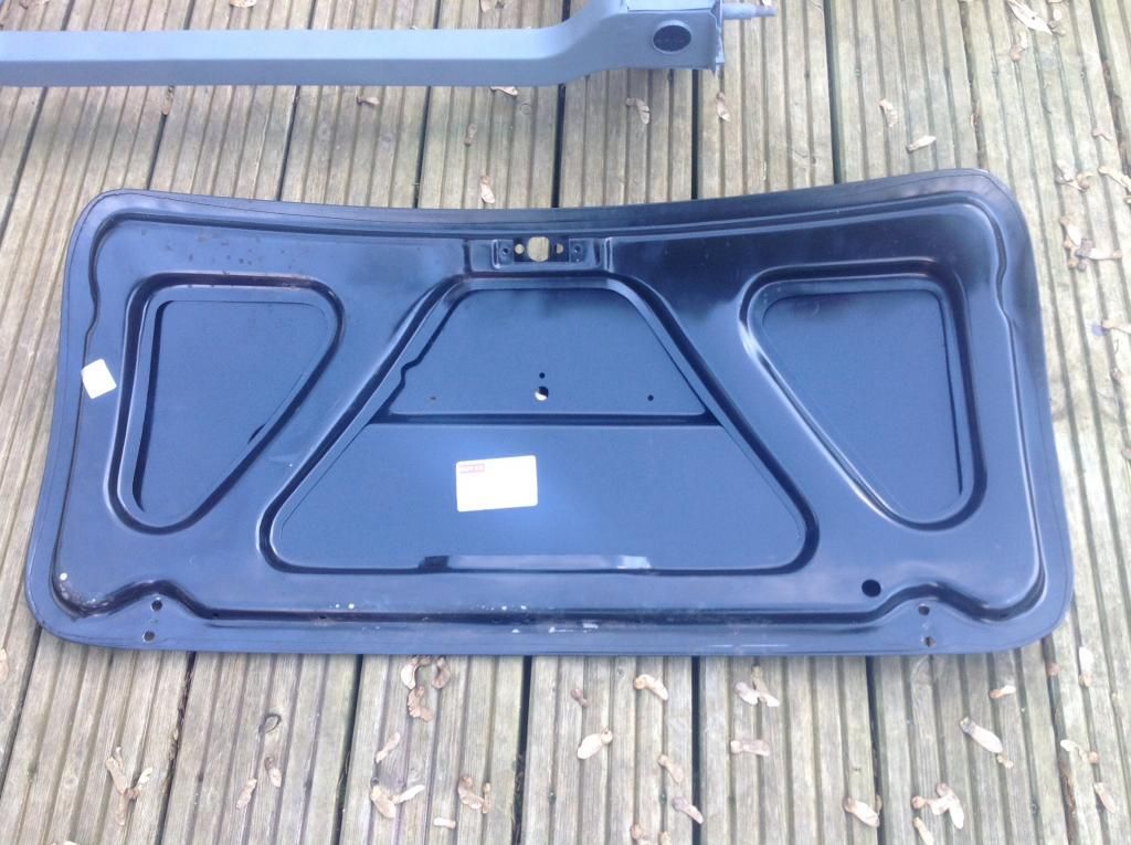

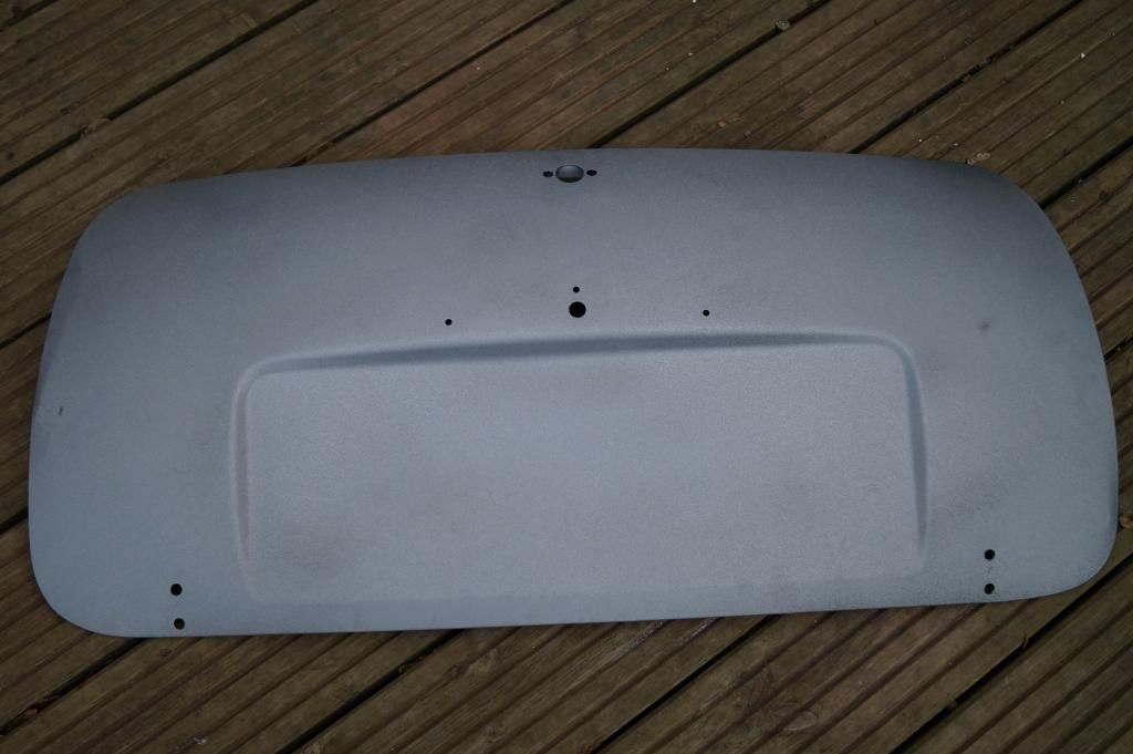

This is the genuine rear bootlid , needs some work as it has some spider webs or rust and a few dents that need sorting , plans are to get it blasted and get "the mini hospital" to sort the dents etc out for me .
Cant really moan for £51 though !

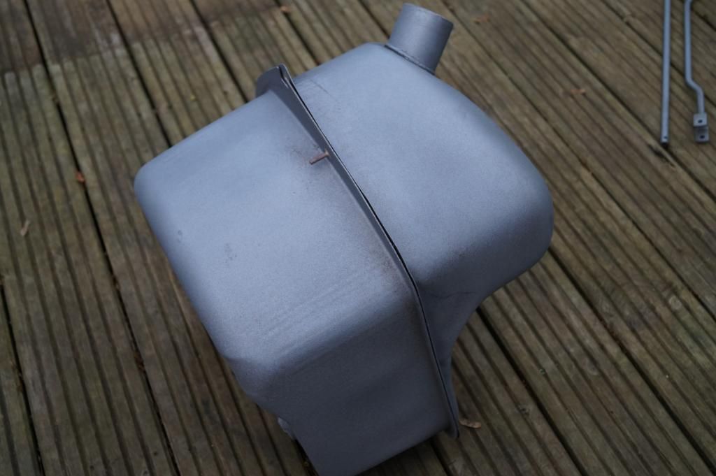

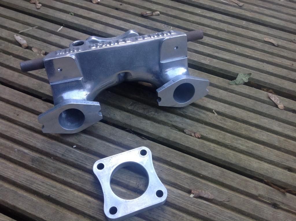

Alloy inlet that has been polished and flowed
Bought an alloy carb spacer for it too.

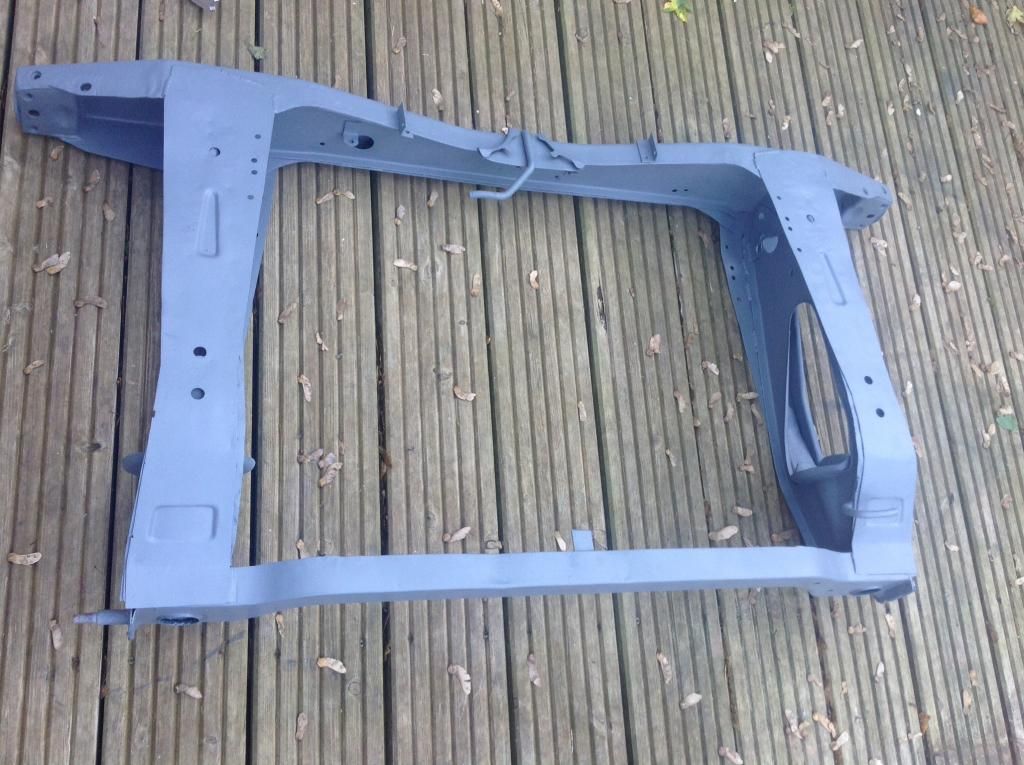

And i have been working on the rear subframe i got from Jordie , genuine frame that was sandblasted before i got it but the rust was starting to come back through, so i had it skimmed over with blast to get the rusty bits off and bought x4 subframe repair panels, now its nice and solid again and no rust, paint isnt just primer is cold galvanising spray that we had a load of at work , question is now do i paint it in 2k or stonechip then 2k ?
Spending the rest of this year collecting panels and parts then the real work begins next year.

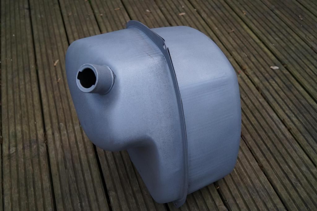

picked up some bits from the blasters today , nice and clean !

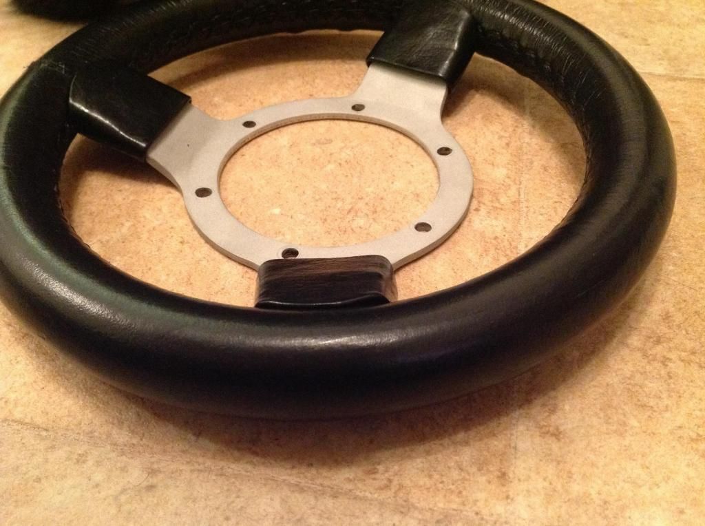

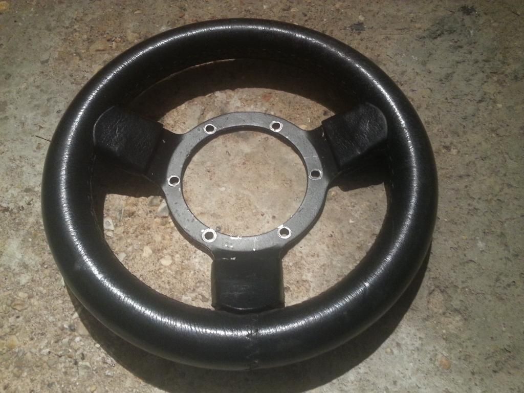

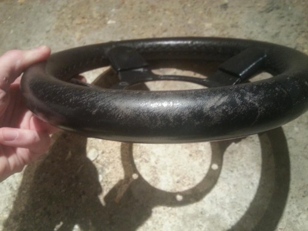

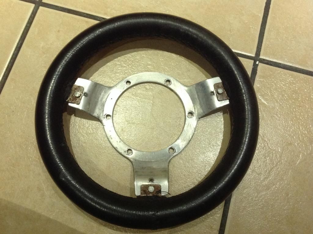

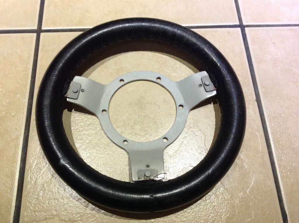

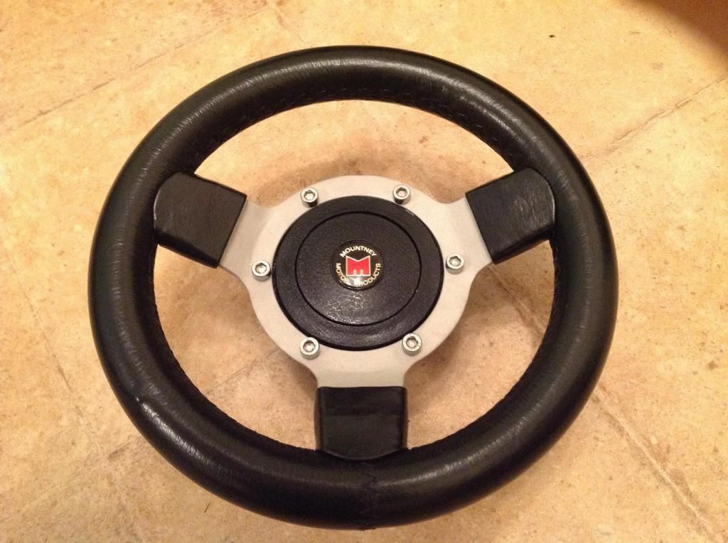

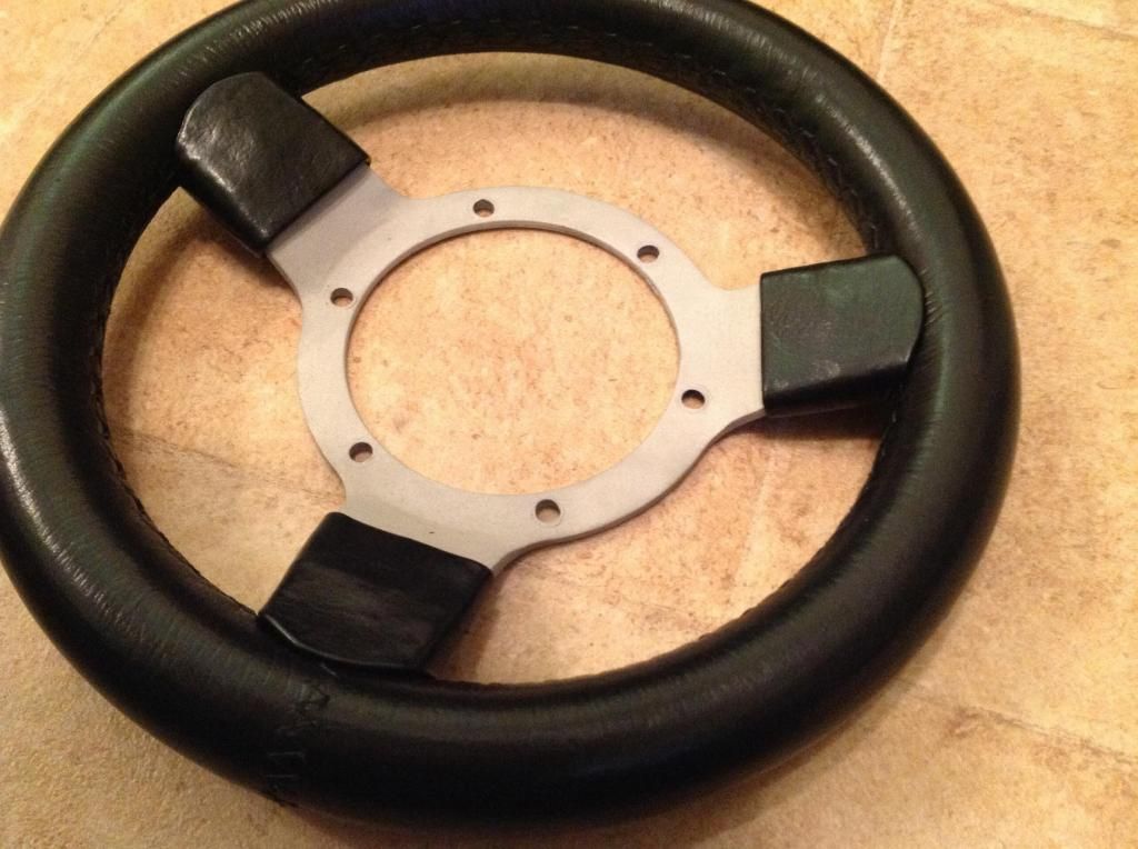

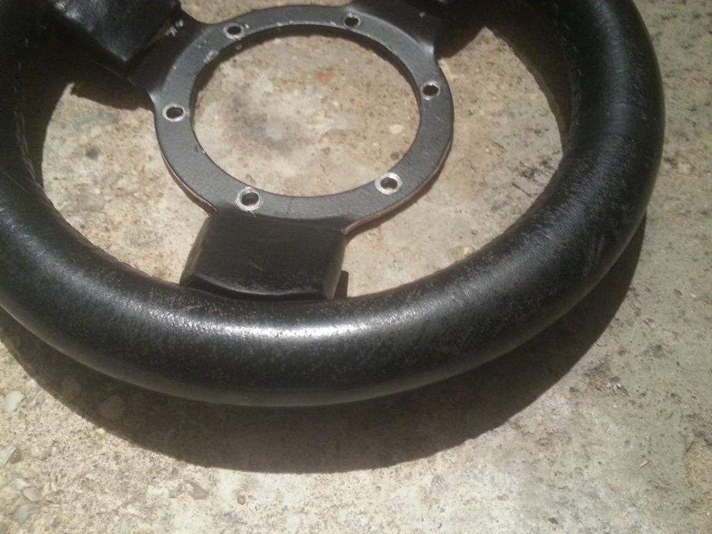

bought a 10" mountney steering wheel off ebay that needed restoring
stripped the black paint off the centre as i was planning on polishing it,
but the alloy wasnt in the best of condition with lots of deep scratches/chips
so i decided to blast it instead.
then i bought a leather restoration kit from here
http://www.leatherre...-Kit/p/11581055
the kit is very good , it comes with alcohol to clean the leather, as the ones on ebay are just a dye etc
the wheel has had 4 coats of dye, 3 coats of gloss finisher and 1 coat of matt as it was sooo shiny lol.
here are some pics of the finished wheel including a new boss for it.
im happy with results!

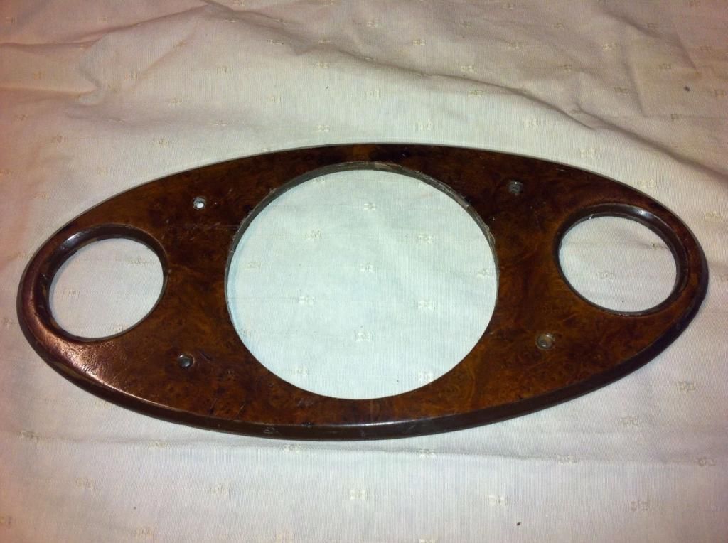

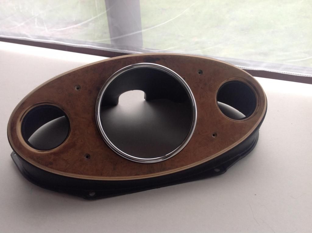

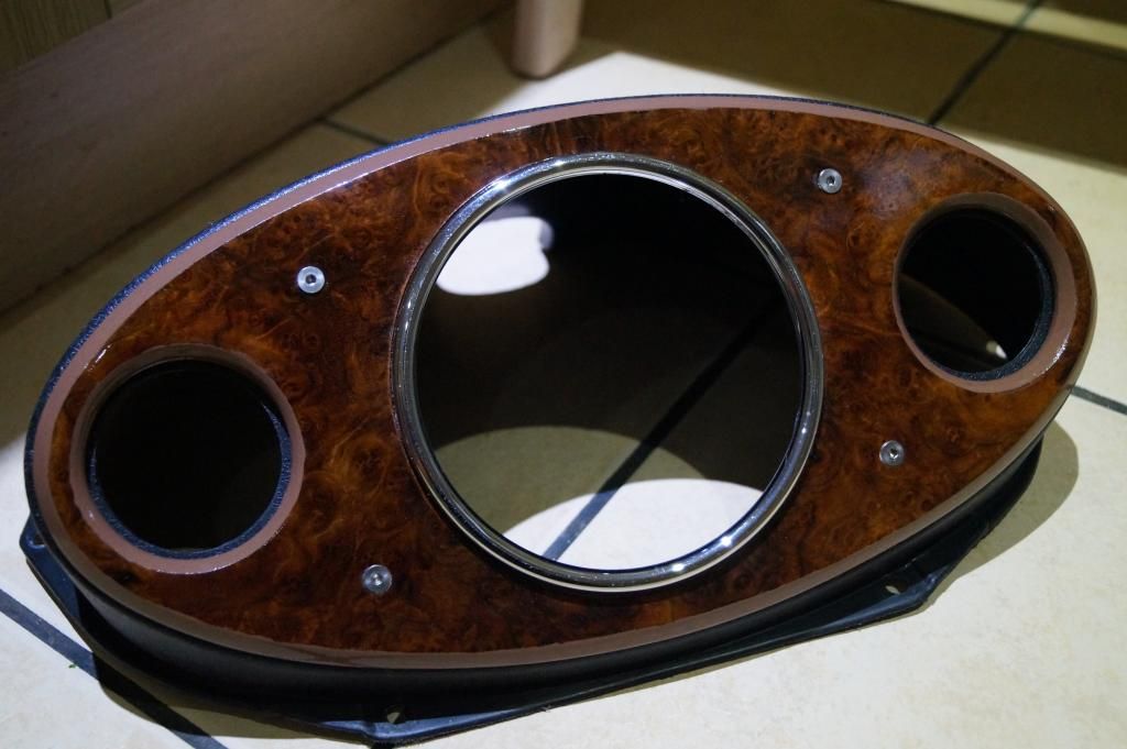

while i was surfing ebay saw a nice speedo surround that needs some attention as i like a bit of wood (oooh eerrrr)
this is it after i had taken all the old varnish and brown paint off it
and here is is complete, its had 10 coats of laquer, the first two coats just soaked right in!

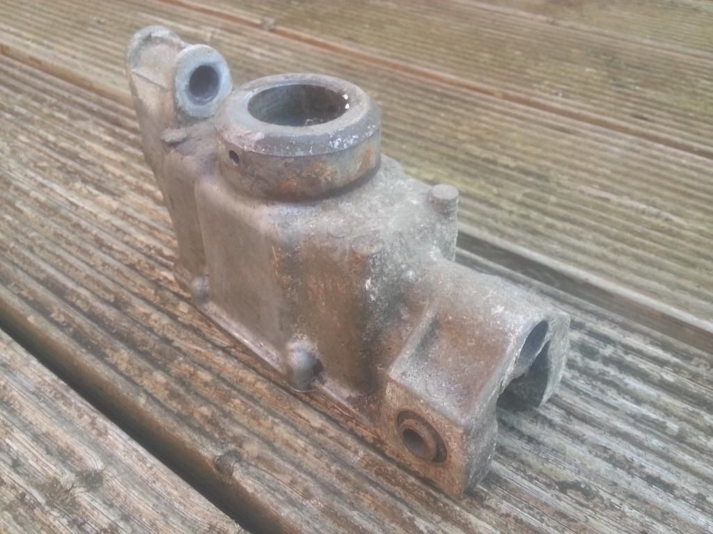

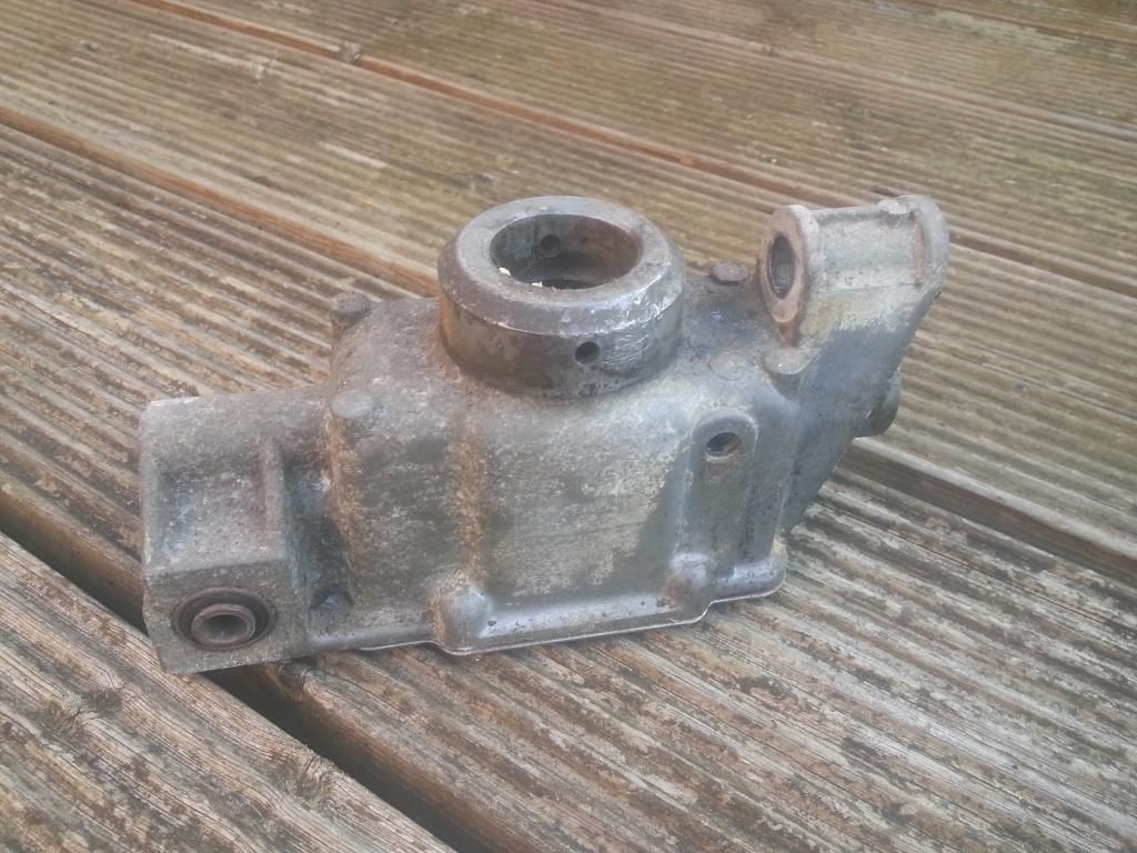

did a bit of blasting the other day too

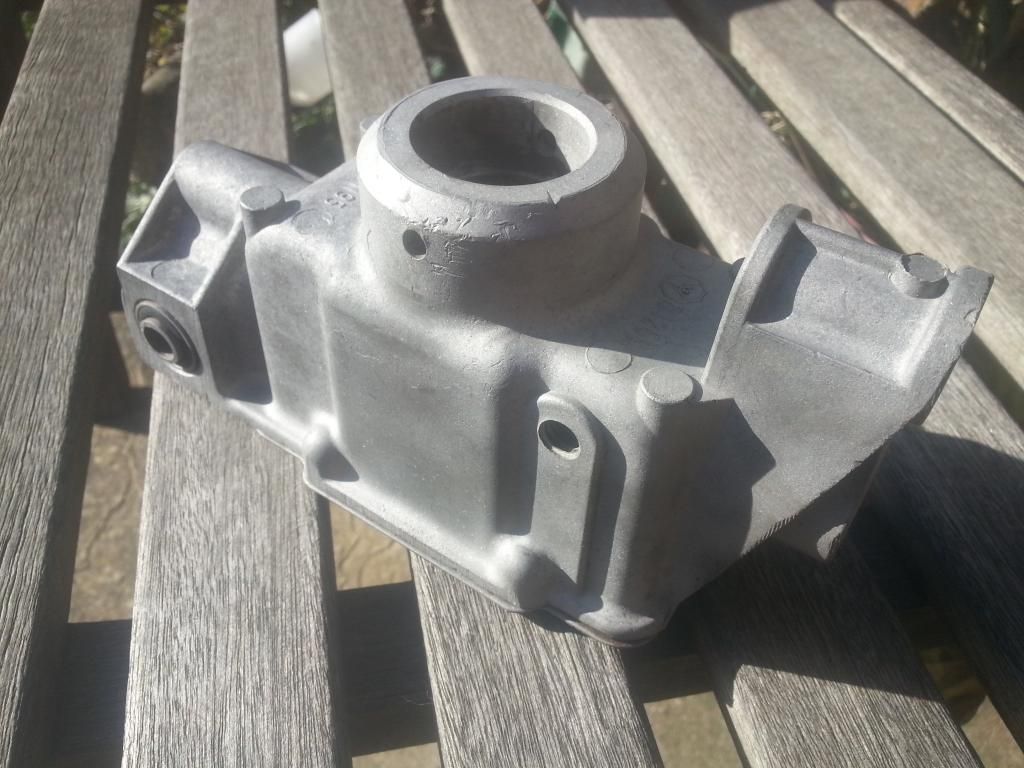

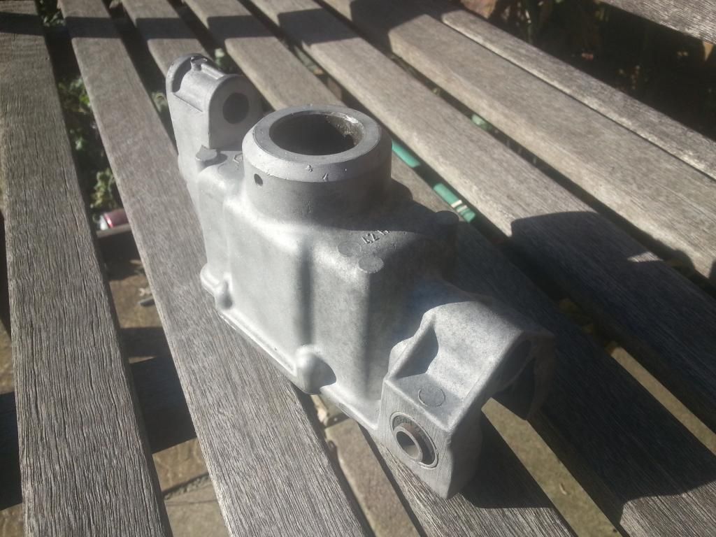

here is the gearchange housing before.
and after, (still not happy with it im going to get it aquablasted)

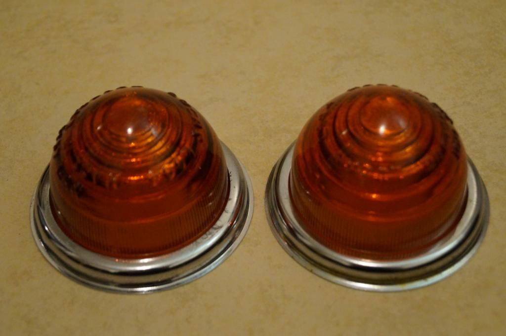

and picked up some lucas glass indicators of ebay for a bargain price !

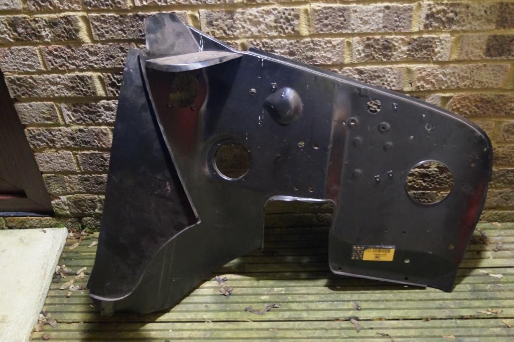

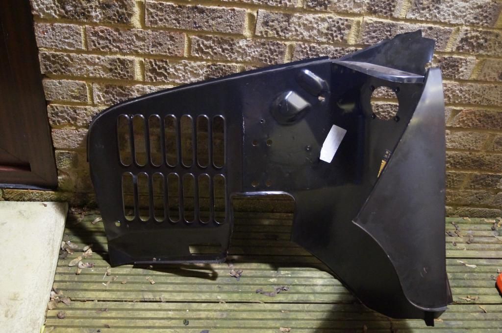

and met Leadly who sorted me out with these lovely panels.....
