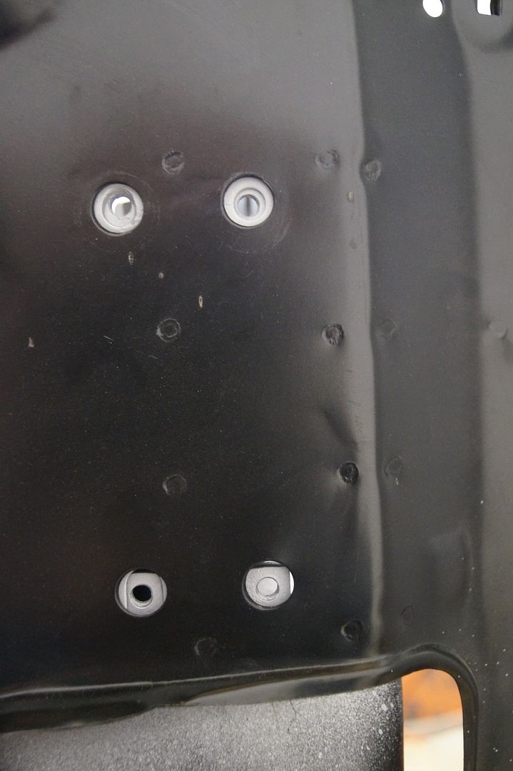

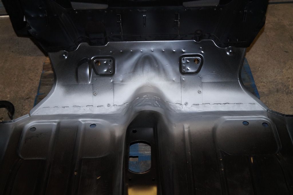

finished welding the floor to the bulkhead, its not perfect and to be honest i struggled with it but its done now , just needs some more seam welding to the underside which i can do later....
chopped off the bits of the c pillars i dont need , and started to clean up where it was welded to the parcel shelf.
this is what was left of the inner c pillar brackets that hold the seat belt mount , i was just going to leave these on but decided to take them off and im glad i did.
as there was rust under them.
and the rust cleaned off back to bare metal and zinc primed, still need work yet but getting there.....

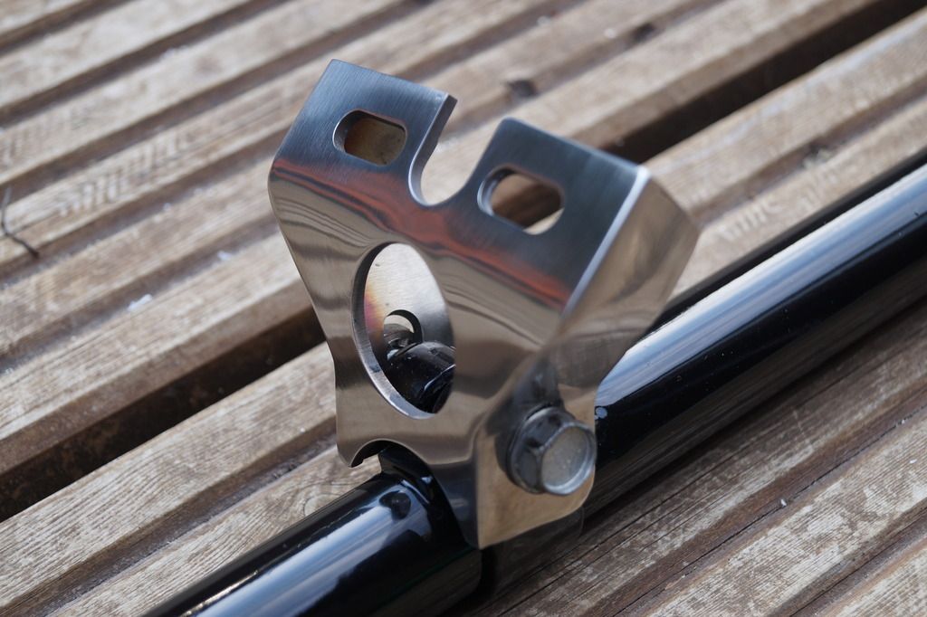

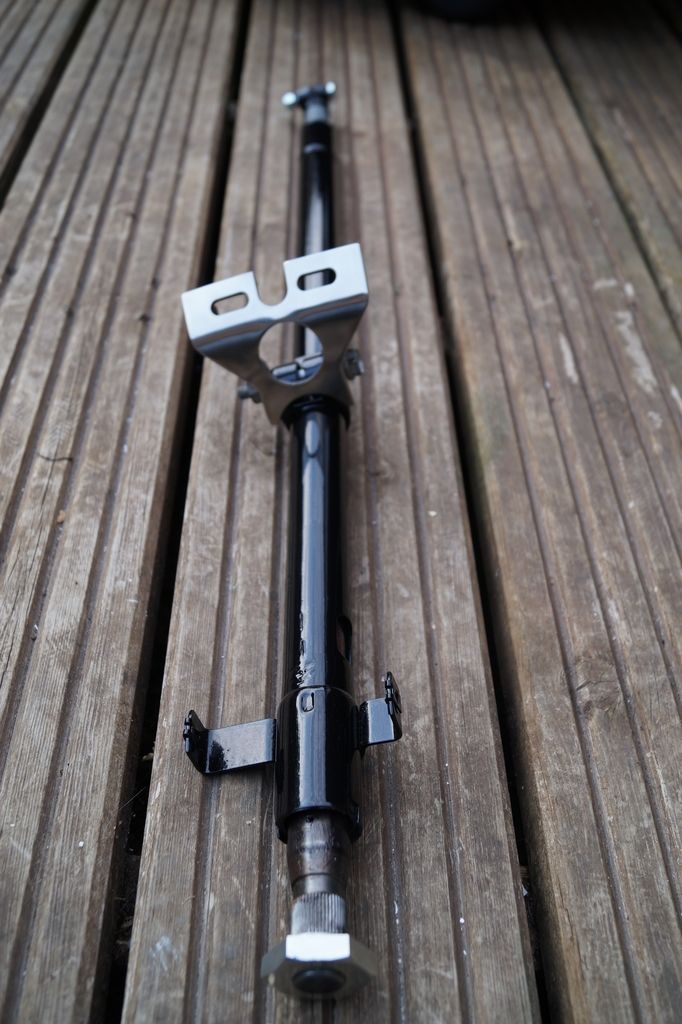

one thing that did come while i was away was my custom steering bracket from Matt at fusion Fabrications made from 3mm stainless, tigged together and polished.
fitted to the steering column
f8d01f65-e146-4dd2-bc13-9405bce5f6a7_zps

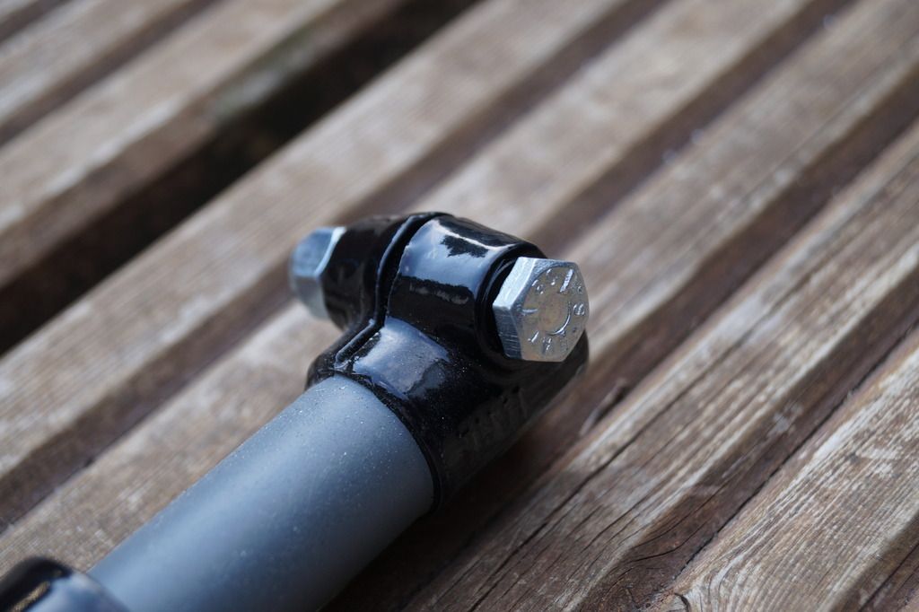

oh and a new bottom pinch bolt

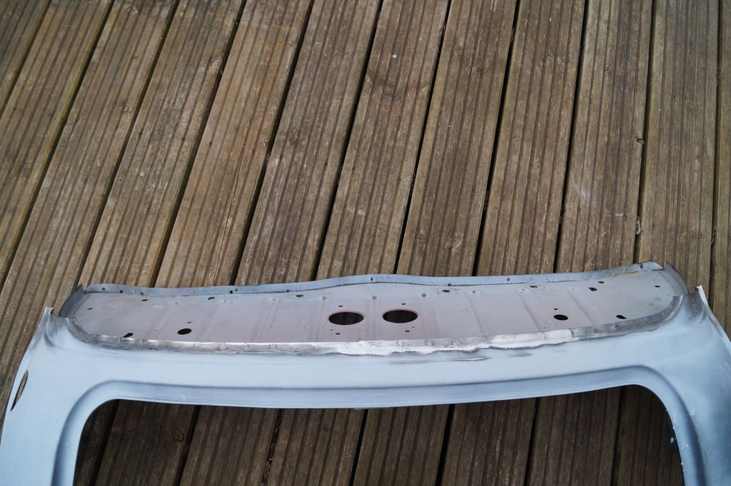

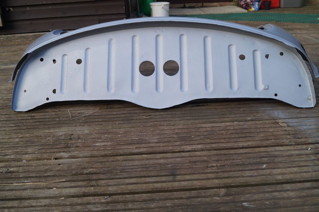

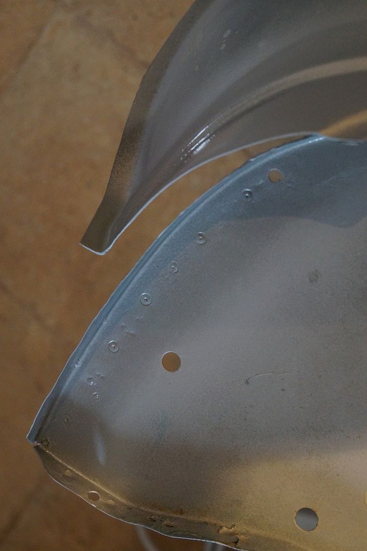

so did some more work on the rear panel, rubbed it all down to bare steel and coated it in zinc primer , and welded up the many holes on the parcel shelf . its getting there but still needs alot of work in my eyes.

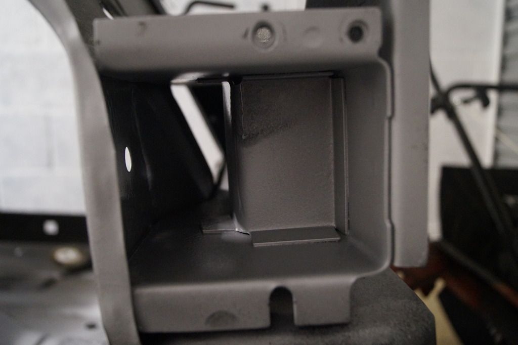

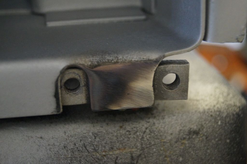

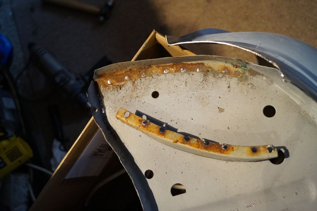

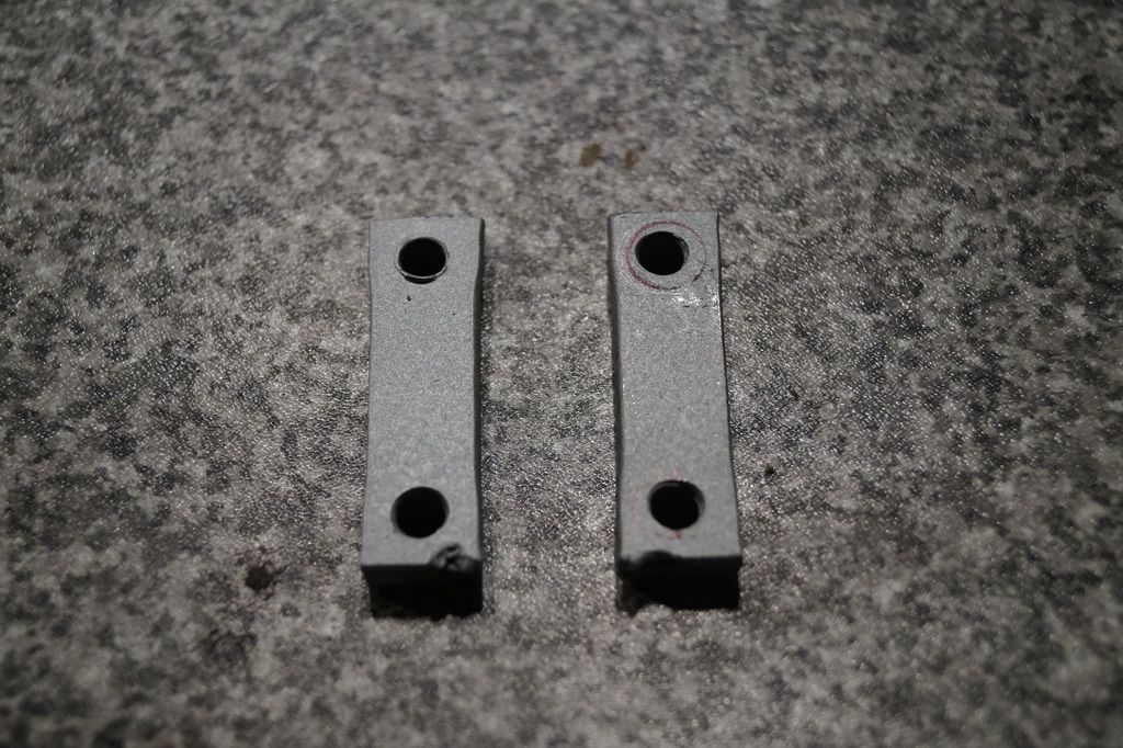

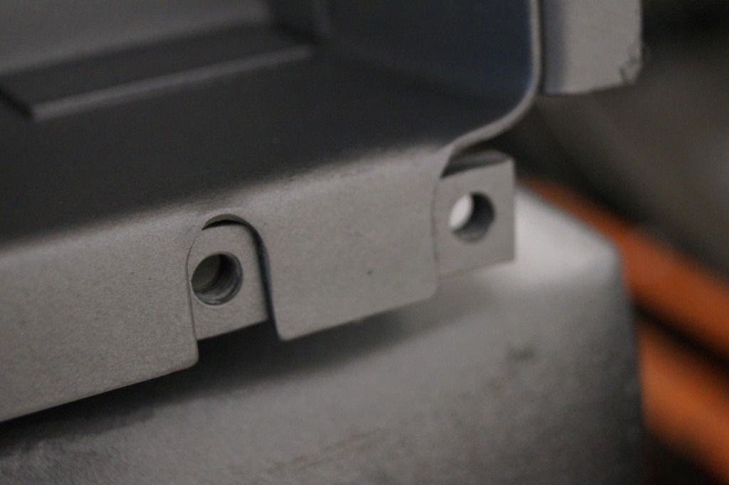

pulled these off the old shell as you dont get them on the new bulkhead,wired wheeled them and left to soak in vinegar overnight, hit them with some zinc spray, and filled the inside box section with zinc primer, wanted to soak it in paint so it ran onto all gaps...
plug welded them on as the top ones are plugged on.
and zinc over the top

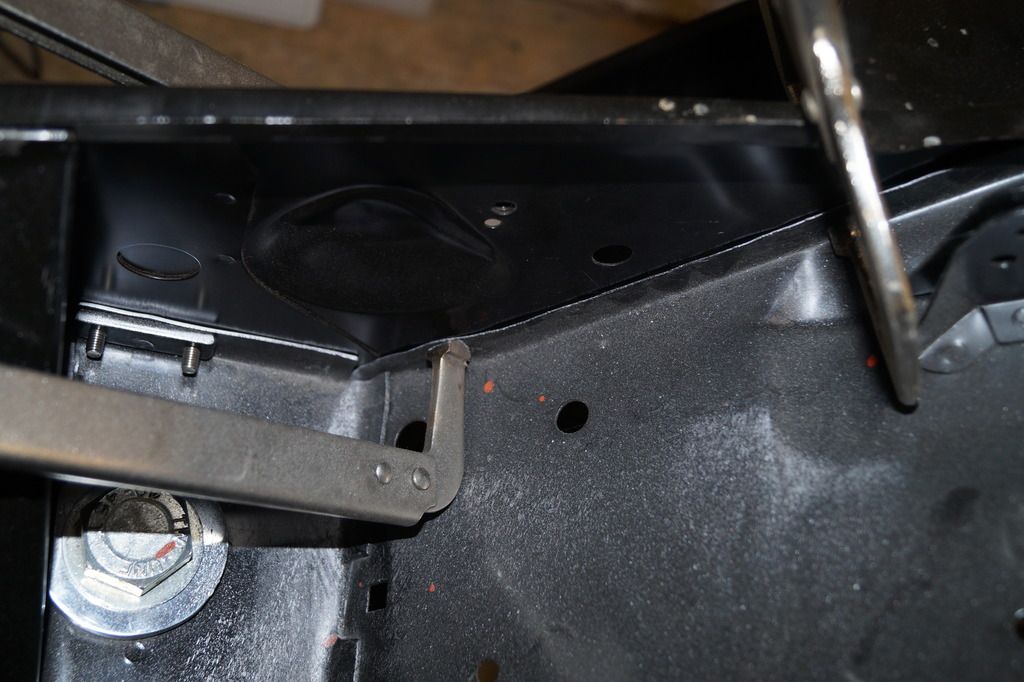

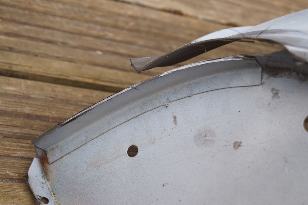

what do you think this fits like ?
bit to the right of the clamp isnt great only about 1.5 inch though.

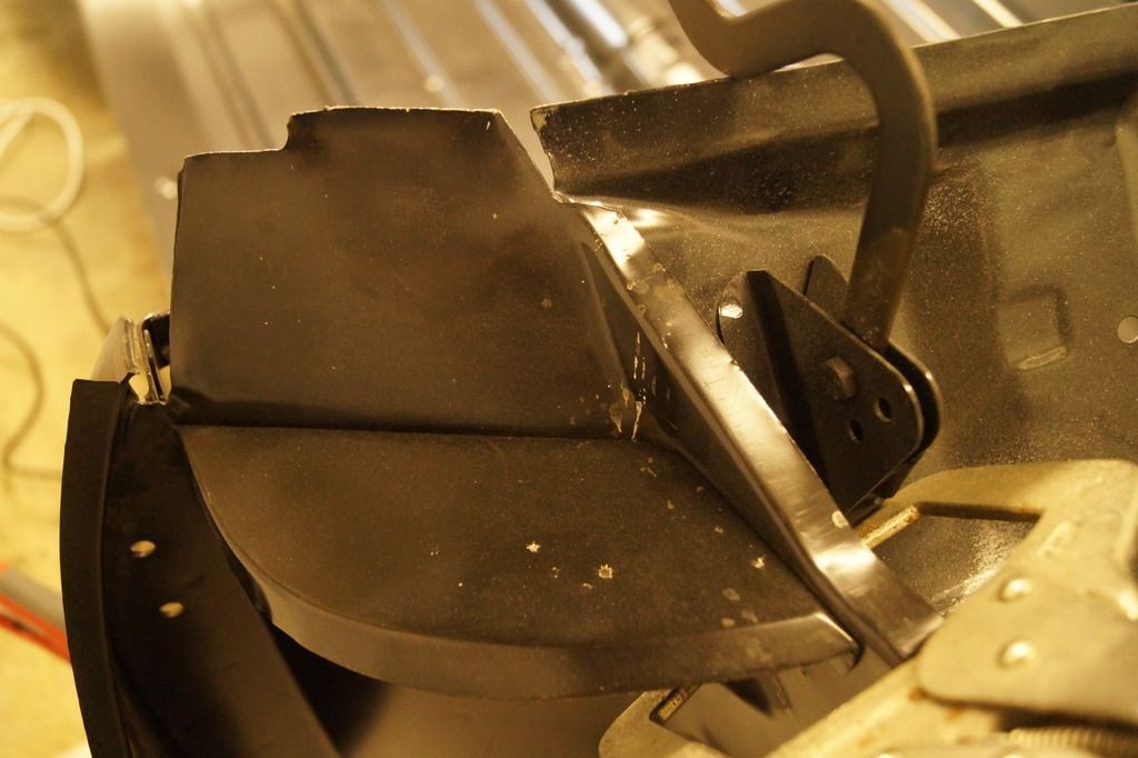

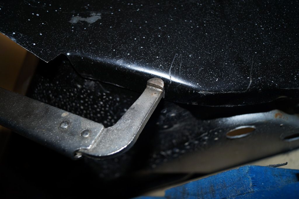

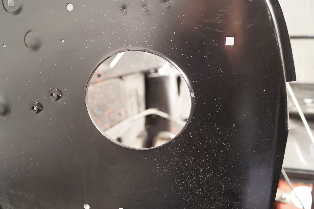

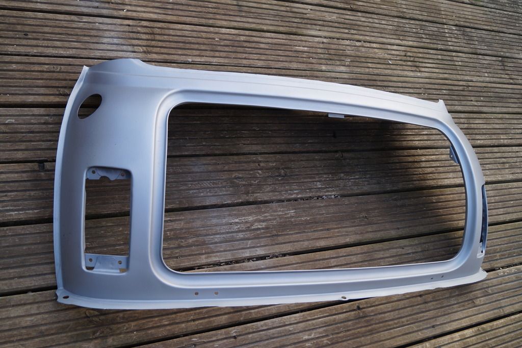

anyone any thoughts on how the inner wing fits ? does it look right? feel free to speak up lol

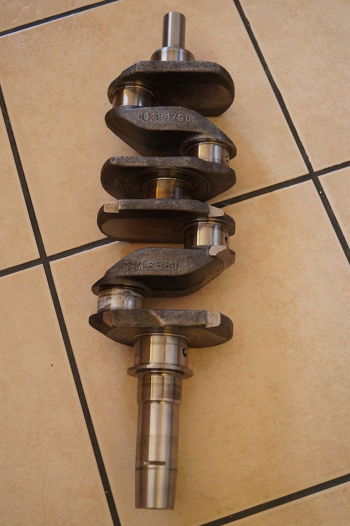

managed to source a 1275 turbo crank at the weekend, very good condition ends , just needs a grind to the next size.
better than paying £300 for a new one , would have used mine but the taper was completely knackered ....
#114 Ben_O
Ben_O
    Mill Road Garage
  • Paint Doctor
  • 9,794 posts
  • Location: Isle of Wight
Posted 10 September 2015 - 09:39 PM
I had exactly the same problem with my inner wing.
it wouldn't fit nicely to the floor so i had to perform surgery.
http://www.theminifo...rebuild/page-56
#115 James_eaton_thewholething
  • 1,063 posts
  • Location: Manchester
Posted 10 September 2015 - 09:50 PM
i had the same problem with both of my inner wings so i just hit it with a big ol hammer i didn't have the patience for surgery
#116 Covert
Covert
  • 526 posts

Posted 11 September 2015 - 05:15 AM
Thanks fellas , ive been tweaking it around for ages must have spent a few hours on it this is the best i can get it , its been on and off soo many times lol,
It just seems to be the one small bit at the bottom , might have to perform surgery !
#117 Covert
Covert
  • 526 posts
  • Location: Northampton
Posted 13 September 2015 - 08:49 AM

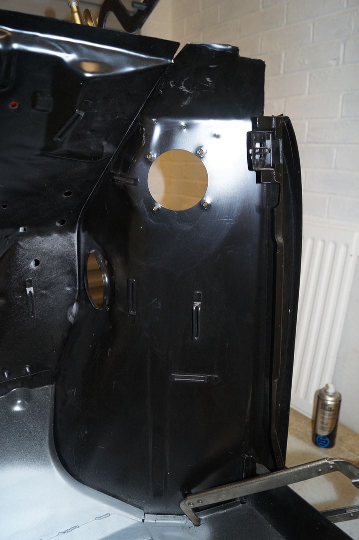

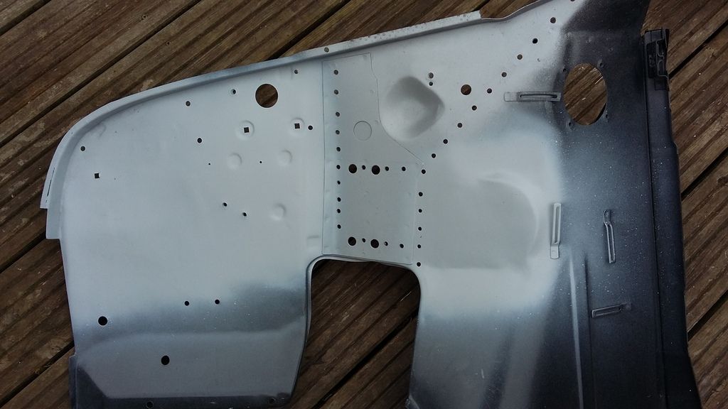

the saga of the inner wing continues.....
what to do with these holes, i dont want or need them, but if i weld them up i dont want to warp the panel ,
id like it to look as if they were not there at all.....
i dont want to weld the panel on till these are sorted as i can move the panel around at the mo.
#118 Ben_O
Ben_O
    Mill Road Garage
  • Paint Doctor
  • 9,794 posts
Posted 13 September 2015 - 02:26 PM
For the hole at the front of the inner wing, i would use a hammer and dolly to flatten the return lip and then use a piece of cereal box held against it to draw round to get a template, cut out of steel and then tack it in place.
Use pulse welding leaving time to cool as you go and you won't warp it.
As for the other one towards the back, it will be a little trickier to flatten out the return lip so you could cut a circle of steel to fit in the hole and carefully weld it in from the outside and then grind the return lip off with a flap disc or something.
Just make sure you weld slowly and allow plenty of time to cool and it will be great. I use a wet rag to quench the welds to speed the process up.
#119 Covert
Covert
  • 526 posts
Posted 13 September 2015 - 04:34 PM
Thanks ben , ive bent back the lips with an adjustable and hamered them flat to the panel, and welded up the 4x mounting holes on the rear hole , just need some steel to weld in the holes, thanks for the advice matey !

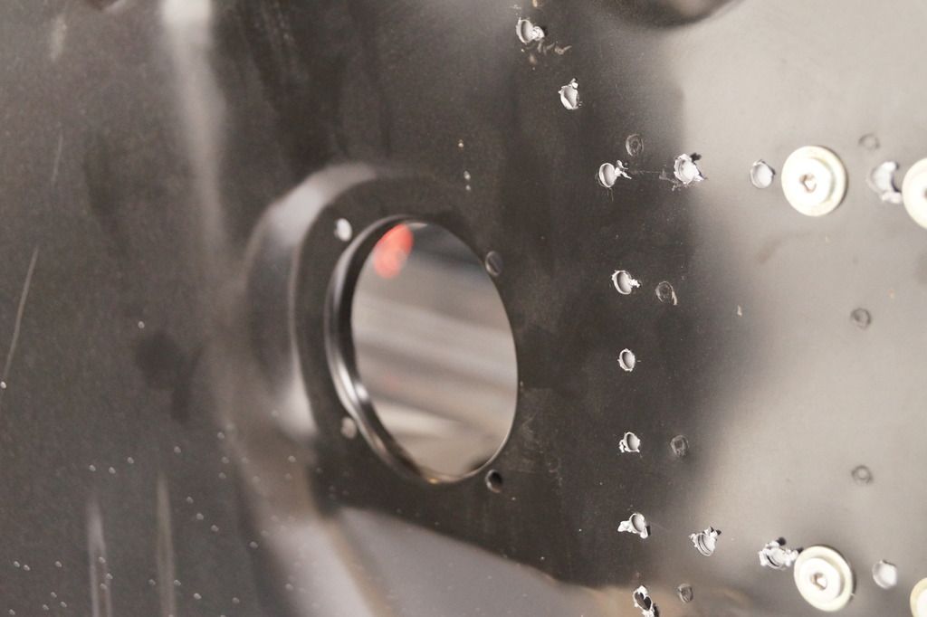

#120 Covert
Covert
  • 526 posts
Posted 19 September 2015 - 05:14 PM
So been working on the inner wing all week, came out ok, are there any other holes I don't need folks?
