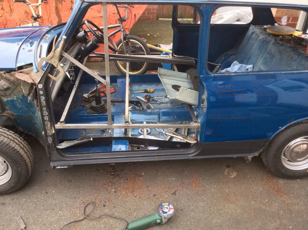

Have you braced the inside of the car ? You need to do this before you chop your inner and outer sill out otherwise your shell may twist

Here's a picture of mine , I've braced to the windscreen as I'm cutting the whole passenger corner out at some point
Cheers James

Yes James I have braced her up a bit, not as much as you have done tho, I hope I've done enough. I've welded some inch box across the door holes then diagonally between the two. My door posts and dash rail and solid and I'm doing the repairs one by one rather than chopping loads out in one go. Do you think it'll be ok? Will try and find a picture. Yours looks a proper job. I remember seeing it on a visit to your build thread. Must check back in on everybody else's work when i get time, I find it very inspiring

Bracing looks good, but I would reconsider the inner sill left inside the car, they are not really suitable for a good repair as they fit around the common rot areas and rely on an over outer sill to cover all the holes mini machine inner and outer to first groove are best I know of

Hi daz.... dont worry the inner sill repair panel isnt being used.... sorry for the high jack of your thread
