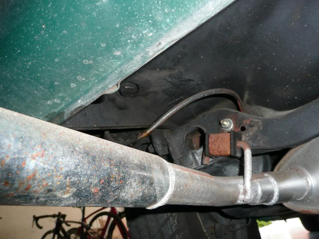

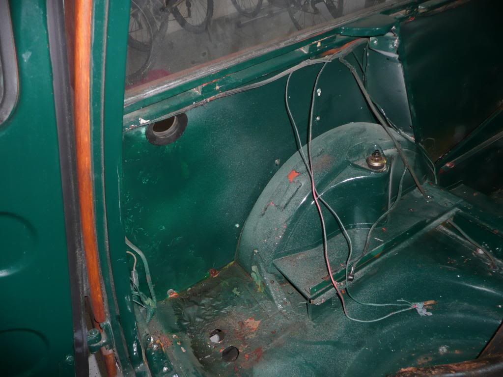

My name is Bala, I am new to this forum and I will attempt to restore our 1962 Mini Countryman. The car has been sitting in my girlfriend parent's garage for years collecting dust and recently we were given an ultimatum to move the car into our own garage (I know... Didnt want to clutter our garage). Well, after doing a little bit of internet browsing, I was motivated/inspired to start/attempt our own project and I intend to do a complete restoration to this mini. With that said, budget is very limited and therefore, this "project" should take a long while, specially considering the fact that I would like to do it properly and cut as little corners as possible. Another big limiting factor is that I have no experience with bodywork or metal work or welding so I am not sure how this is going to pan out.
Anyhow, so far, we have towed the mini home, we have prepared our garage/working space and we have started the dis-assembly and parts cataloging.

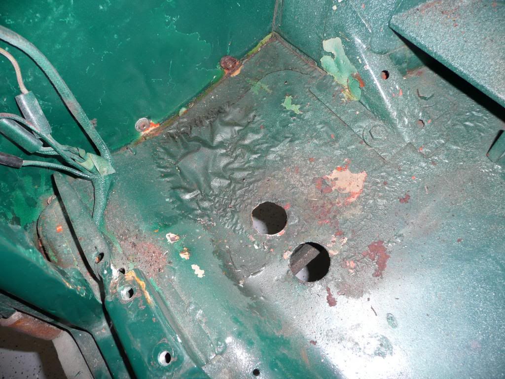

The shell condition is not horrible but there will be some panels that will need to be replaced I am sure (front floor panels looks like they have been repaired in the past and it was not done cleanly). I will let you guys be the judge, thanks.

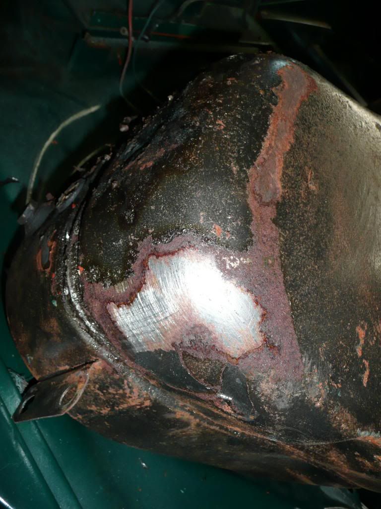

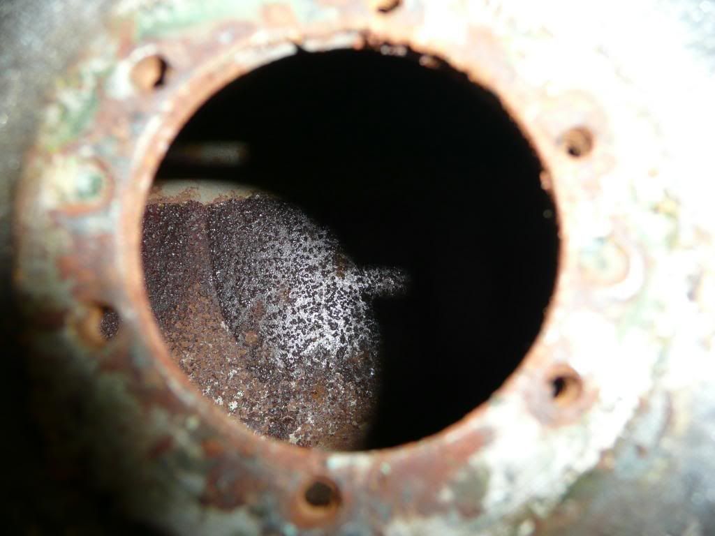

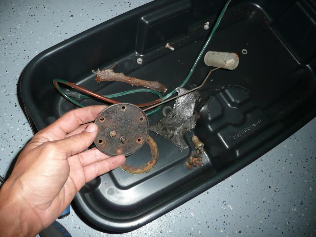

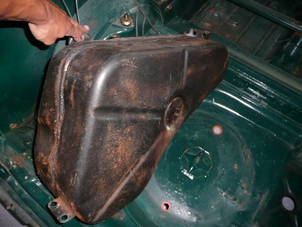

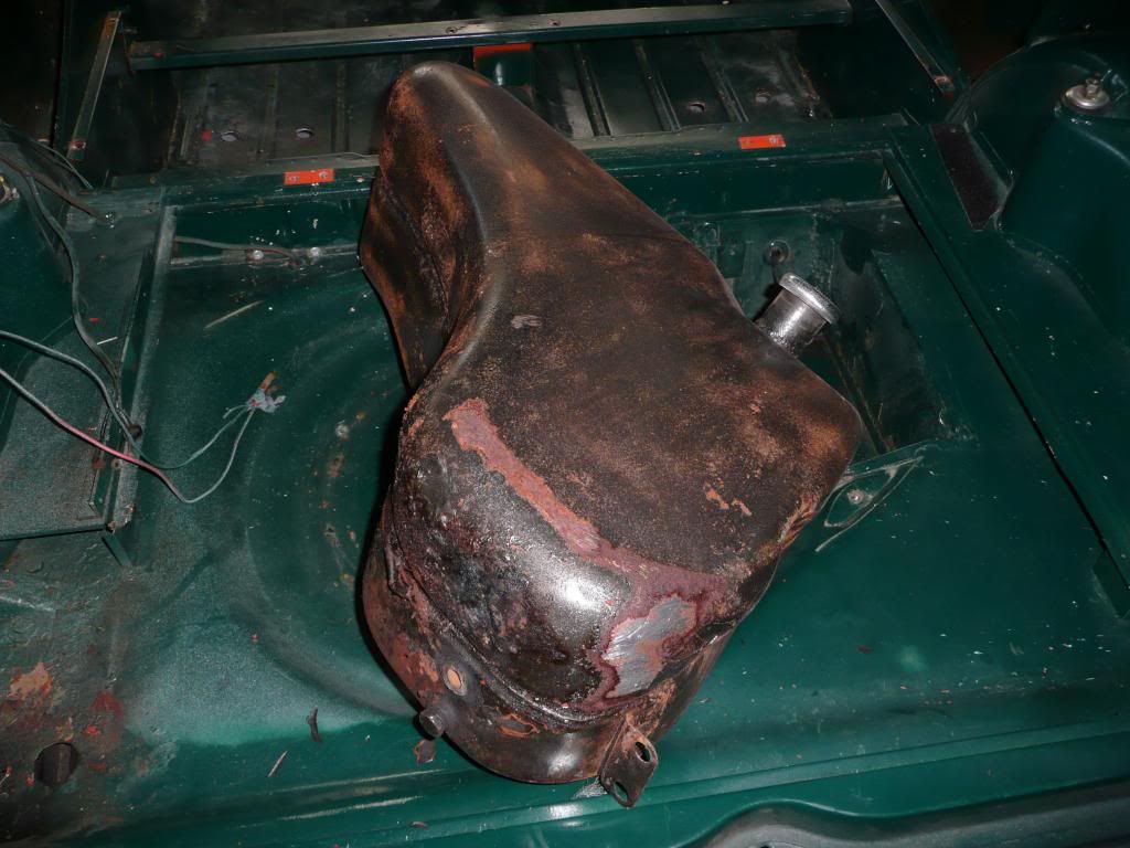

Removed the internal tank today... Lots of rust inside the tank and I am pretty sure it leaks. Dumped out about two hand full of rusty grit. Getting this tank back to like new condition should be a straight forward process... I think. Has anyone ever used METAL RESCUE?

I hope you can save your fuel tank as I have a feeling you would be very hard pushed to find another one of those mate.
It doesn't look too bad under the tank has been, If that had been here in the UK then im sure we would be seeing plenty of the tarmac thru there lol.

Nice looking project, I have used POR15 tank sealer on a rusty motorcycle tank and it did a brilliant job, so I would recommend that. You buy it as a kit with a rust treatment you use first. What you would need to do is protect the filter on the pick up pipe if one is fitted to stop that getting sealed up. Meant to be a permanent fix, mine was done a few years ago and still looks like new inside.
