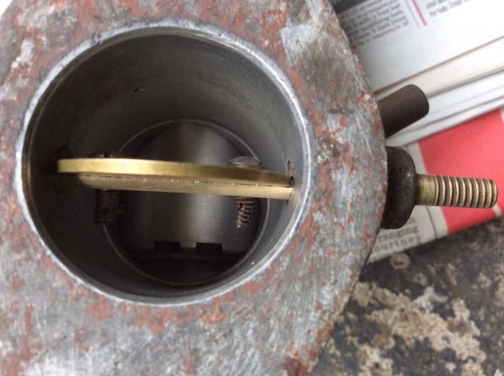

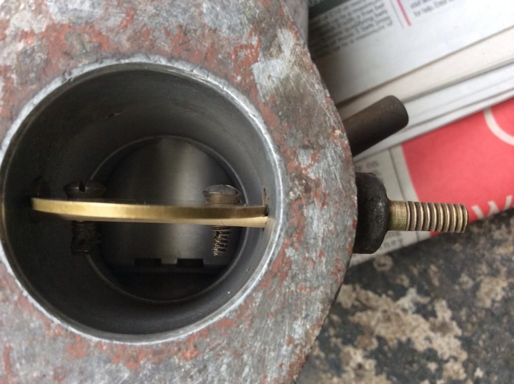

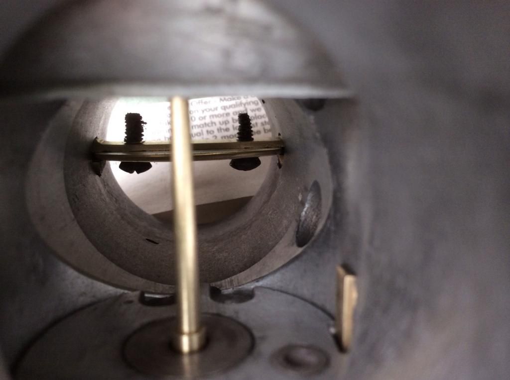

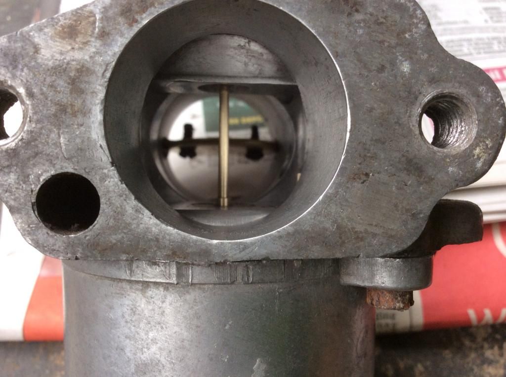

Heres a few Piccys..... They need a good clean aswell.....
Also had the sides of the inside smoothed to get rid of all the sharp edged etc
Cheers james

#15 jpw1275
jpw1275
  • 2,803 posts
  • Location: Warrington
Posted 15 June 2014 - 07:17 PM
The casting inside isn't the best as standard
