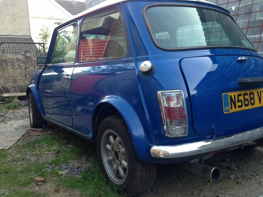

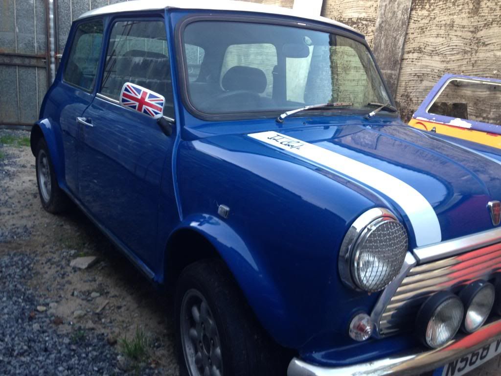

#10 exuptoy
exuptoy
  • 674 posts
Posted 19 June 2014 - 09:04 PM
I just got this and it was painted in 2011 and covered in stickers, removed the stickers and machine polished the paint with a Maguiars DA mop and some Farecla G3 rubbing compound. Not even polished and waxed yet. Paintjob isn't the best due to but it holds a good shine and reflection.
5A4B76CD-6D41-4207-A810-9D545B50C7A3_zps
02BB2860-D034-4E38-8878-66DC43CE3F63_zps
