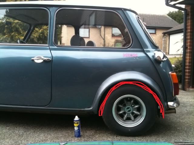

If you could get me a photo of how the arch goes along here that would be great too.
Mine sits above the metal lip (on this photo it is pretty much sat on the lip)

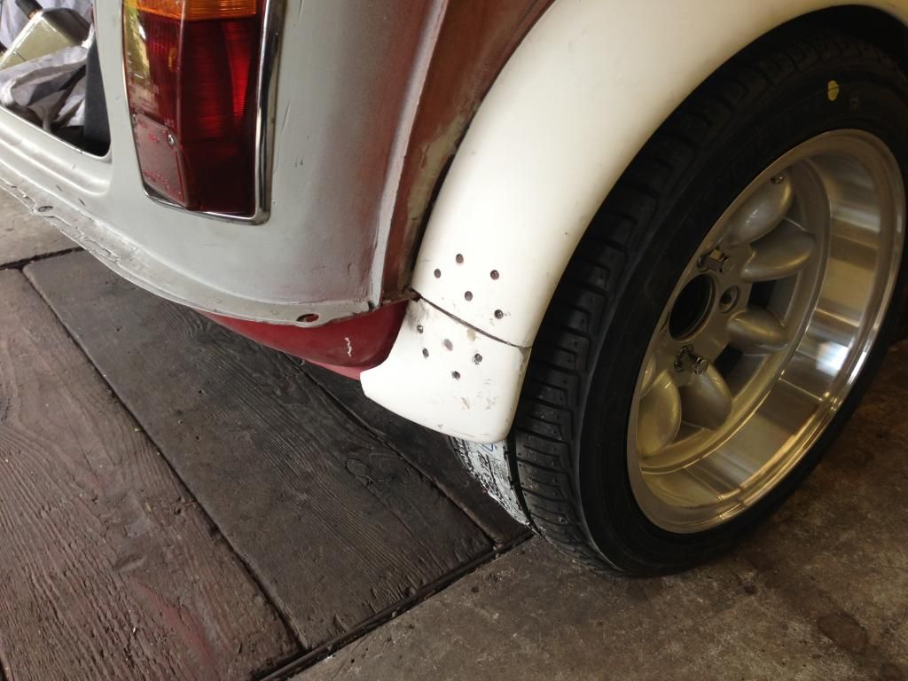

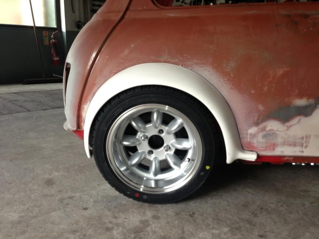

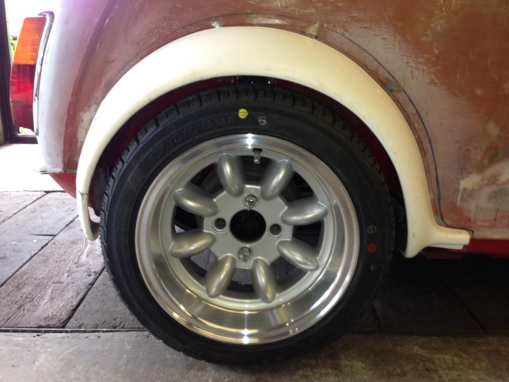

these are my copy (fibreglass) sportspack arches fitted the rear wheel arches have been tubbed.
as low as the coilover will go
normal ride height
arches were too long, so I fitted them where I needed them and chopped them.
Edited by bartman, 19 June 2014 - 01:31 PM.

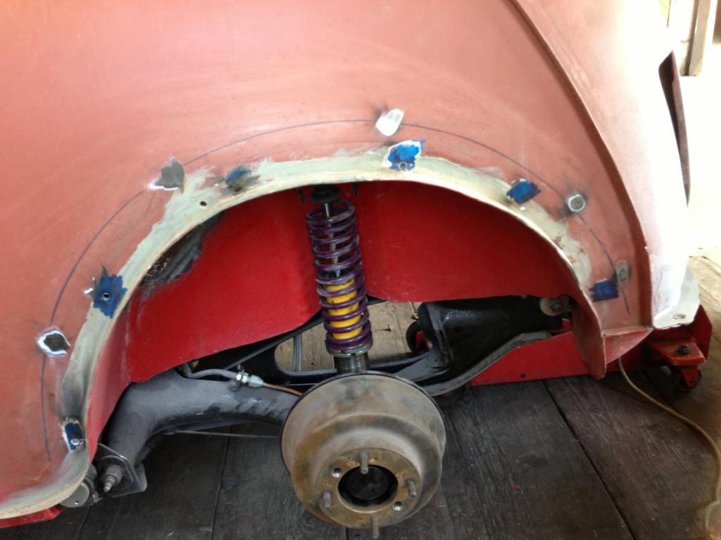

Posted 25 June 2014 - 05:28 PM
I would love the adjustment you get with the arches being tubbed!
If you can get me a photo of how the arch coveres the metal arch lip or if it doesn't. I am just debating if its worth me going genuine for better fitment.
best I have without arch. wheel arch lips sits on arch lip
