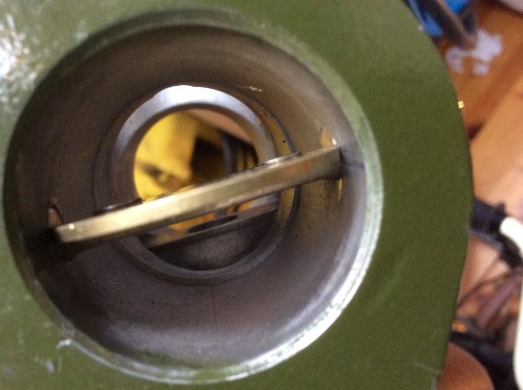

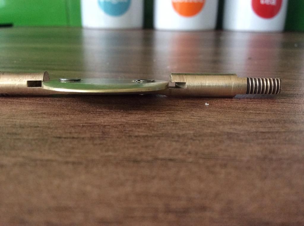

Hi all.... Does anyone know the thread and size of these little screws as I'm after getting domed screws to replace the standard ones, these are to fit twin hs2 carbs
Cheers james

They are Whitworth thread, will try to get back with the size. I think there is a very similar american thread.

The butterfly screws are 1/8 inch Whitworth thread, this has 40 tpi.
The American UNC 5-40 thread is very close to the 1/8 Whitworth.

Hi all.... BA5 fit just fine.... I went for flat heads and 1/8" in length..... Also countersunk the screws in a little aswell
Cheers James
So if anyone wants any new screws for there butterfly shafts and using twin hs2's then BA5 fit
Just remember to thread lock them in.... 1/8" does not protrude out of the other side of the shaft
And are a million times better than the original screws regarding airflow
