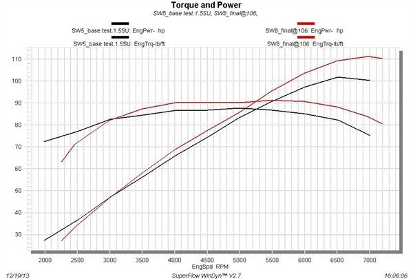

When discussing cams the most important thing is to have the cam graphs and then compare their outputs to your desired driving style.
If you want real top end power and are prepared to use up to 7000 rpm, then go for a cam which gives peak power at 6400/6500 rpm.
However, if you want your engine to have a longer life before re-builds, look for a cam with peak power at 5500/5700 rpm and only use a maximum of 6000 rpm.
Doing this means that you are choosing the cam by using proper engineering techniques instead of going on 'bar-room BS' about this cam & that cam.
Personally I never use a cam for which I don't have a proper graph as without one there is no way of knowing how it will fit the intended use.
There is more nonsense talked about cams than anything else in Mini engine building & modification.

#14 gkmini
gkmini
  • 266 posts
  • Location: Calgary
Posted 03 July 2014 - 03:58 AM
You mean like this one?
Edited by gkmini, 03 July 2014 - 04:02 AM.
#15 TR7
TR7
  • 431 posts
Posted 03 July 2014 - 06:01 PM
This is why im looking at the sw8 cam as it looks to be a better cam
