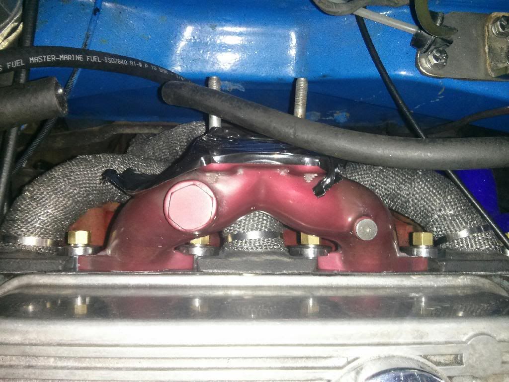

Anodise it :-)
IMG_20140315_122539_zpsofgugrm_edit_1394

Posted 23 July 2014 - 01:05 PM
I painted mine with standard outdoor enamel and its holding up fine!
