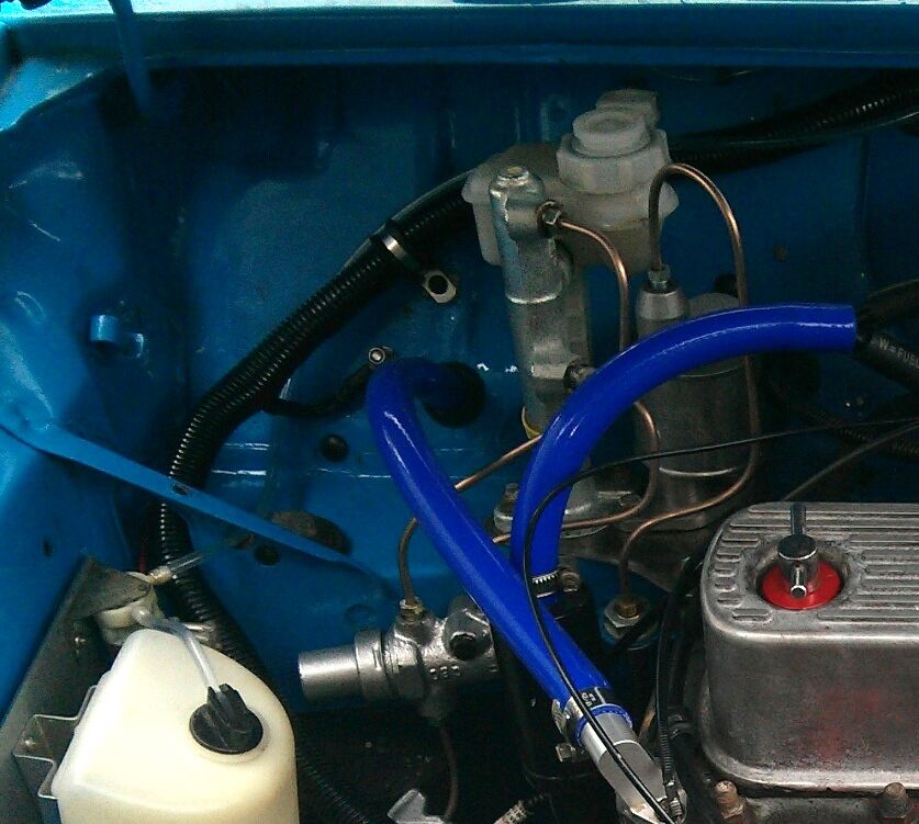

Mine was done by hand:IMG_20140428_153636_zpsg3neczy_edit_1406
Just go steady and as said have a practice first.
