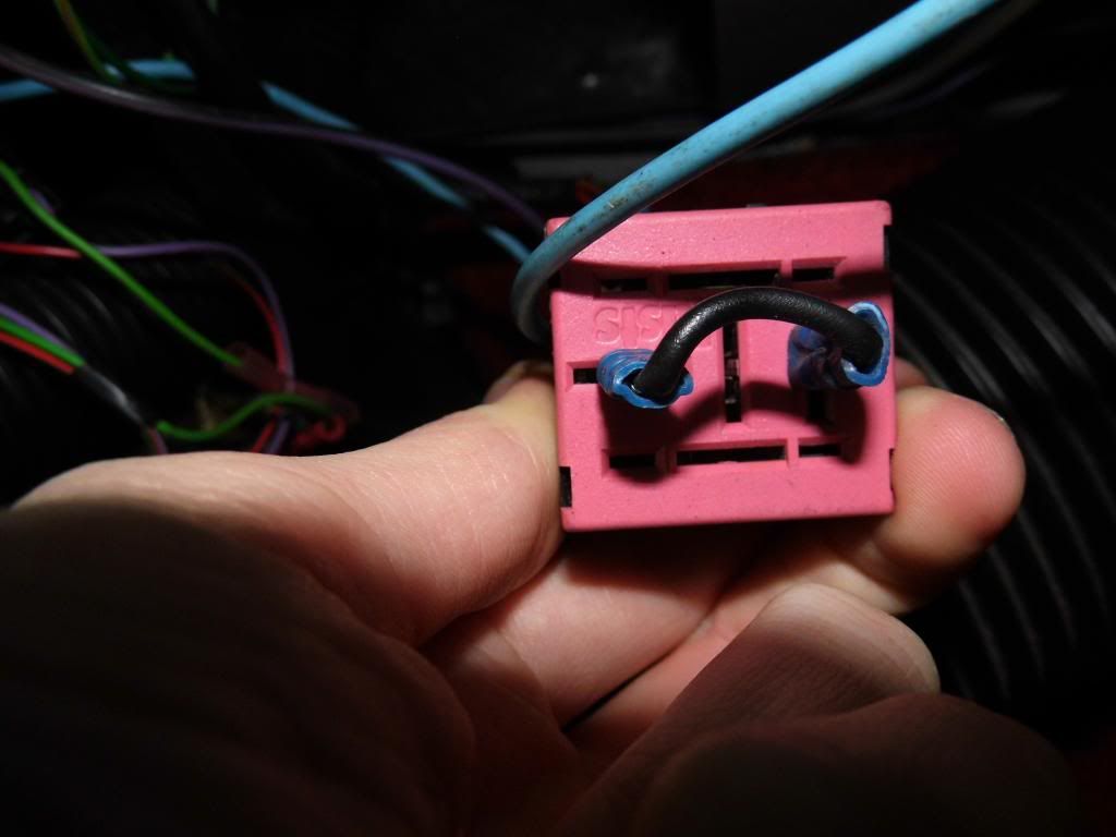

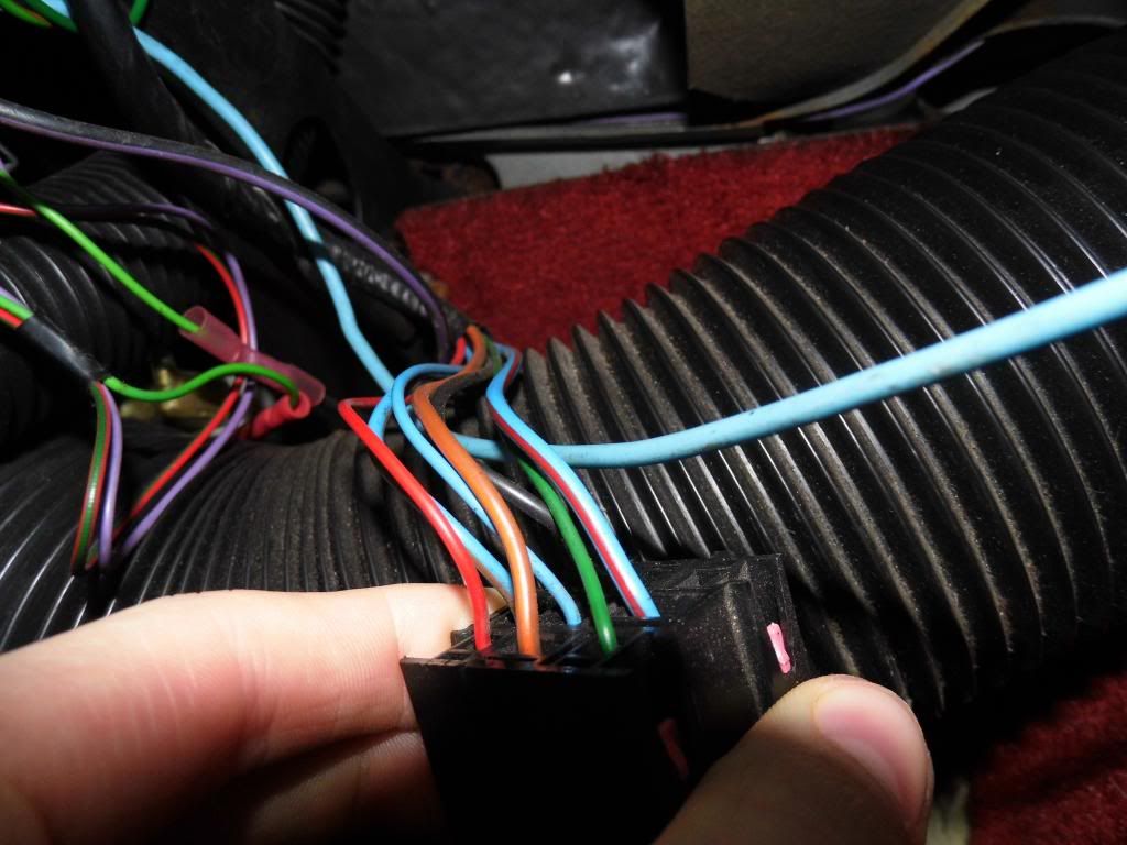

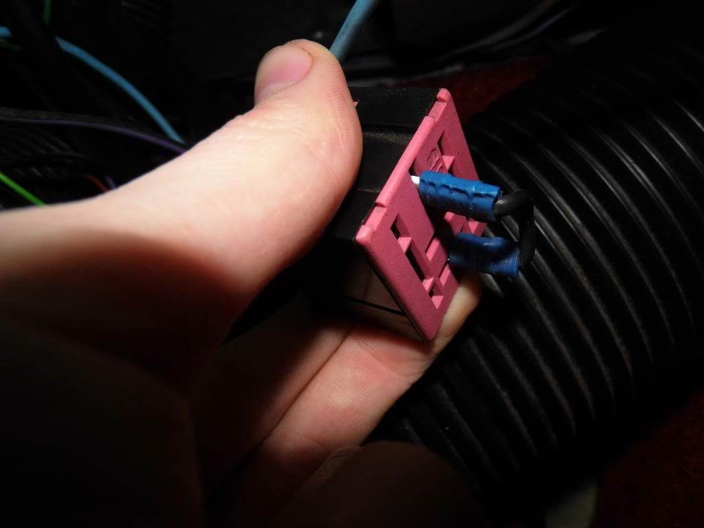

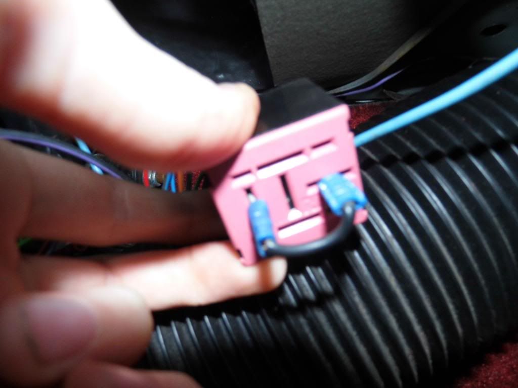

an auto electrician did it for me
it must be
and we dont need it over here but they put it in anyway as far as i got told ive uploaded a picture

Simply remove the relay and join the Blue/brown wire to the Blue/red wire then the unit becomes completely redundant,
Yes its safe it was only introduced so you could not drive on sidelights, but it was dropped and most cars have been modified, as per the link wire in the above picture by Kieran
